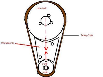

Me and my friend alligned the cam shaft dot with the crank shaft dot, then with the harmonic balancer. I bought a repair manual and it shows me that the cam shaft is supose to line up with sometingn on the oil dampener, then the crank shaft is also supose to alligne with something on the oild dampener. However we alligned the cam and the crank to eachother. We did not use a repair manual or timing light we just eyeballed it like I said. However I bought the repair manual today and it shows that the cam and crank allaigh on different spots on the oil dampener. I want to make sure im not just missreading the diagram and instructoins. So if you could double check I would appreciate it. Ill attach a picutre of what it looks like in the diagram.
Tuesday, October 28th, 2008 AT 12:23 AM
LUTHERNICHOLS2769
  • 9 POSTS
Heres the diagram as shown in the GM Chilton repair manual
https://www.2carpros.com/forum/automotive_pictures/262534_Timing_Set_Diagram_1.jpg

  • 75,992 POSTS
The pic below does it look anything like yours for cam/crank alignment?

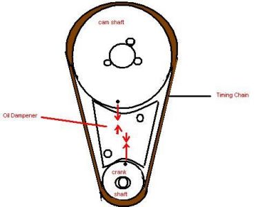

Well no. Me and my friend alligned the cam gear dot inline with the crank gear dot. Unlike in the picture in the repair manual, where it looks like they line up with something on the oil dampener seperatly. And NOT with eachother. The picture below is how we did it.
https://www.2carpros.com/forum/automotive_pictures/262534_Timing_Set_Diagram_g_2.jpg

  • 75,992 POSTS
Did you put the engine no.1 piston on its compression/TDC before you line the cam and crank-also did you stabbed the distributor properly and align rotor to no.1 cap tower

  • 75,992 POSTS
Oh! Boy-okay disregard the distributor its a DIS-if its not on no.1 piston compression stroke and not align properly it will cause the valve timing to be off-
Wednesday, October 29th, 2008 AT 2:39 PM
