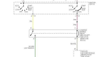

My Firebird has had an issue reading the key to start. Once I made a new key it did not have this problem. Now all of a sudden it acts as if it has it locked out again. Turn the key on everything works. Try to start and nothing. No click or anything just like it did when the security light would stay on. Well the security light doesnot even come on. Any suggestions to get my car back on the road would be very appreciated

Battery has a full charge and connections are good? I can't help you bypass the theft system. In the diagram, the two circuits on top of the enable relay are voltage. On the right, the coil side of relay, ground for the coil side of relay is at the decoder module. On the left side of relay is the load side. When the relay is energized, that line with the arrowhead switches to the other terminal, that voltage goes through the clutch switch, from there to the purple wire at the starter solenoid. Any testing make sure the tranny is in neutral and the e-brake is set.
https://www.2carpros.com/forum/automotive_pictures/170934_firebird_starter_circuit_1.jpg

No it was the anti theft. It had fried! I found a man that knew how to bypass it completely. Thank God because that would be really expensive to replace. All he did was track down the wires and spliced two of them with a single ground. I don't know how it worked but it cranks and runs now. Thanks for all the advice!
