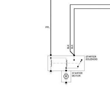

Everything has been tested or replace. When I turn the key to the start position everything goes normal except there is no cranking. I know that the starter works and I replaced the ignition swich but it still wont start. I have checked the park/neutral swich and it is working just fine.

Is there a load on the starter circuit, with key in the crank position? Watch the lites, headlite-- dash lite or something. If there is a load on the starter circuit, the lites should react. If no reaction and they stay bright, you have an open circuit to the starter.
https://www.2carpros.com/forum/automotive_pictures/170934_pontiac_firebird_starter_1.jpg
The purple wire at the starter solenoid, should be hot with the key in the crank position.
Because you said everything has been tested and is ok. The only other thing I can think of, is to pull the plugs and access belts, see if you can turn the crank by hand. Goodluck.
