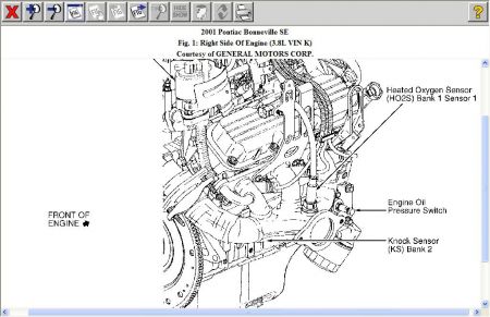

Looking for the oil sending unit. The pressure gauge pegs out at 160. Usually runs at 60
Monday, January 5th, 2009 AT 11:22 AM
MECHANIC
75,992 POSTS
Check the oil pressure with a mechanical gauge if normal replace the oil pressure switch -
If it remains high -check the oil pump pressure relief valve could be sticking closed.
