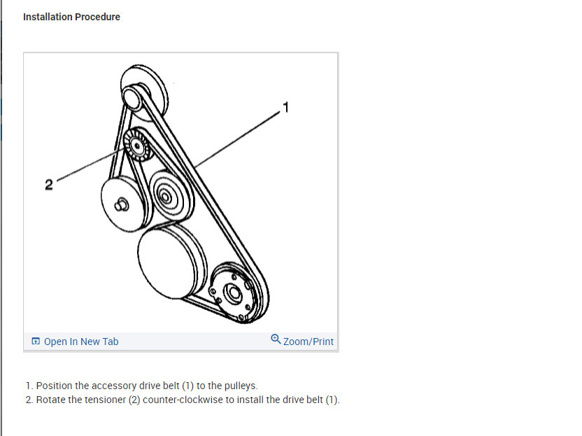

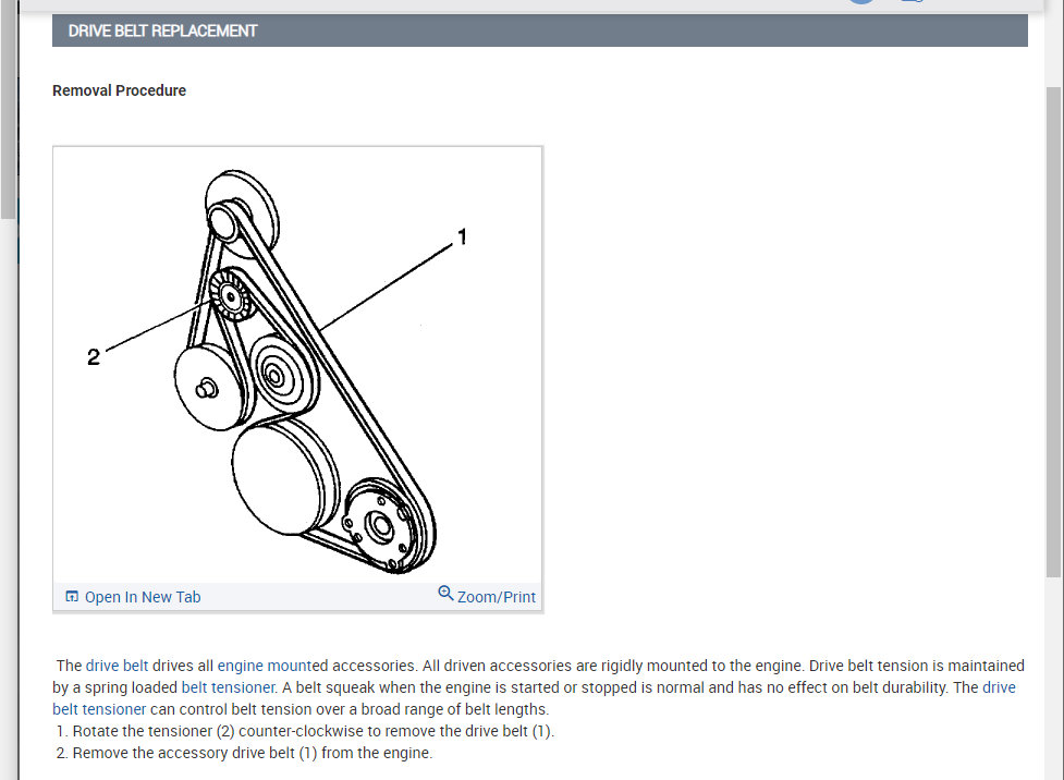

I need to know how to put the water pump belt back on can u please send me a diagram?

Not a problem. Here are a couple guides that will help with replacing the belt:
Here is a video on the same engine that will help with replacing this:
https://www.youtube.com/watch?v=Kzy3wrba7qk
Below is the process from the manual that will give the detail that you may need as well.
Please let us know if you have questions on this. Thanks
