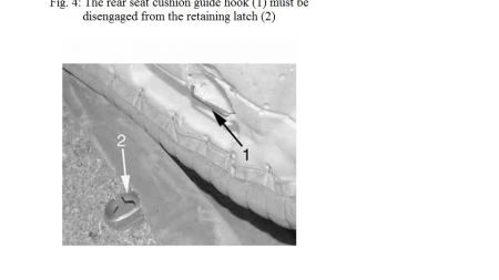

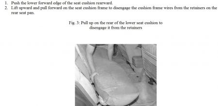

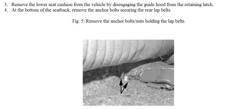

I shut my keys in the trunk and need to pop the rear bench seat to get to em'. How do I do that?

Depending on which options the vehicle has, I'm guessing you don't have a key fob that has a trunk release button? Also, there may be a release button, lower part of driver door armrest. I'll look for rear seat removal.
