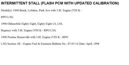

INTERNETMECHANIC
  • 700 POSTS
I saw a service bulletin for intermittent stall, not sure if that will help you? Fuel pressure spec for key on engine off, 48--55psi. Thanks for the donation.
https://www.2carpros.com/forum/automotive_pictures/512072_bonneville_service_bulletin_1.jpg
