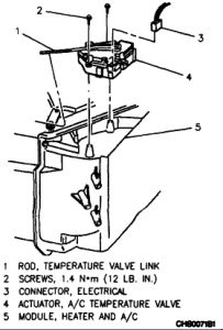

I need to know where abouts is the heater acutator is located in my car.

It's under the dash, mounted on the top of the heater housing.
