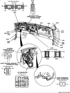

1994 Pontiac Bonneville where is the starter enable relay
1994 PONTIAC BONNEVILLE
ARODRIGUEZ1111
Electrical problem

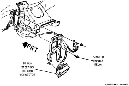

im trying to fix my 1994 pontiac bonneville because it wont start im pretty shure its the starter enable relay but i cant find it so if u could help me finding out whrere it is located i would greatly appreciate it.
Jan 27, 2010 at 8:15 PM
  • CAR REPAIR CONTRIBUTOR
  • 75,992 POSTS
1994 Pontiac Bonneville V6-3800 3.8L STARTER ENABLE RELAY System Locator: Theft Deterrent System
https://images.2carpros.com/forum/automotive_pictures/12900_s1_29.jpg
LH Side Of I/P, LH Side Of Steering Column
https://images.2carpros.com/forum/automotive_pictures/12900_s2_28.jpg
The Starter Enable Relay is located behind LH side of Instrument Panel (I/P), above I/P fuse block.
