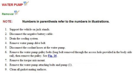

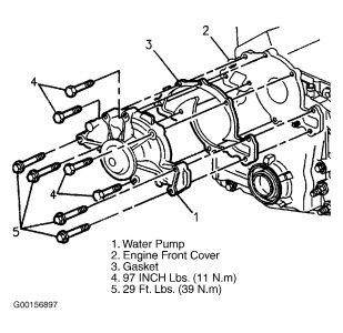

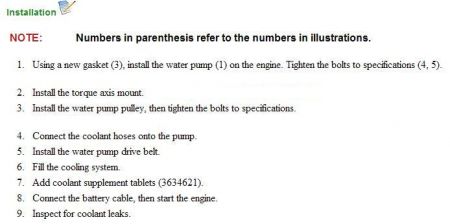

How do I replace an water pump on a 1994 pontiac bonneville?

FIG. 16
