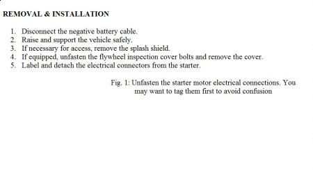

How do u remove the flexplate 2 get the starter off.
Monday, March 8th, 2010 AT 2:23 PM
JDL
MECHANIC
16,098 POSTS
Hi, you don't remove the flywheel/flexplate. You may need to remove the dust cover?
