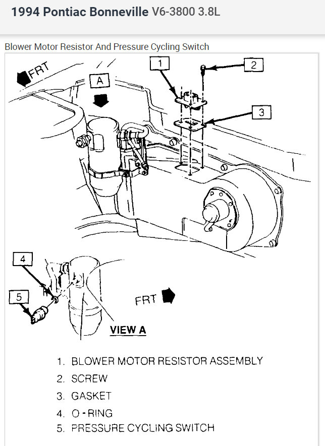

I just change my motor blower, but now the problem is just don't turn off. Please help! !

I would check the switch in the dash, it may be improperly functioning causing it not to turn off.
Does it adjust to different speeds or stay on high at all times?

This happens when the blower motor speed controller goes out, here is the location so you can swap it out and fix the problem. Check out the images (below). Let us know how it goes
