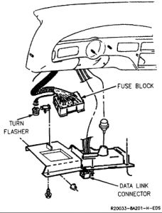

where is the data link connector located and how do I get to it

Location-see below:
Data Link Connector
Behind LH Side Of I/P, LH Side Of Steering Column Support
