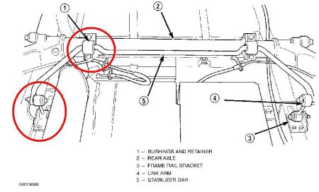

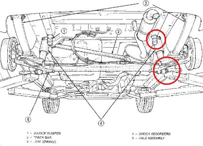

My van is making a rattling sound from the passenger rear wheel area whenever I go over a bump. It is also vibrating the whole vehicle at highway speeds, but only intermittently. When it starts to vibrate, I can slow down and it will eventually stop. I don't know if the two problems are related or not. I also don't know if it is pertinent information or not but I had the rear brake shoes replaced, cylinders replaced, and drums turned this past July.

[Quote]It is also vibrating the whole vehicle at highway speeds, but only intermittently[end quote] You also may want to check these suspension parts, along with the shock absorber and the wheel (for possible bent rim - but I highly doubt it).
https://images.2carpros.com/forum/automotive_pictures/55316_99caravanrearswaybar_1.jpg
https://images.2carpros.com/forum/automotive_pictures/55316_99caravanrearsuspension_2.jpg
