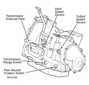

Used ATF + chry fluid if not need to do so
Need to scan system for codes
I would suspect input and output sensor
also solenoid pack on the tranny is a common problem
https://www.2carpros.com/forum/automotive_pictures/99387_Graphic9_4.jpg
