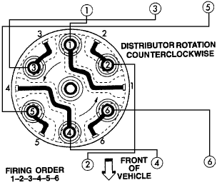

I' trying to find out the firing order for the spark plugs in this vehicle. If possible do you have a picture of it and how it goes?

Thank you so very much but I messed up. I need the firing order for the spark plugs for that same vehicle only its a 6 cylinder, 3.0, on the plymouth voyager 1998. I' sorr about the mistake, but if you could send me that info and picture I would appreciate it. Thank You

Ok, Let you slide this time (haha).
Here ya go......
https://www.2carpros.com/forum/automotive_pictures/188069_98voyfirorder3L_1.gif
