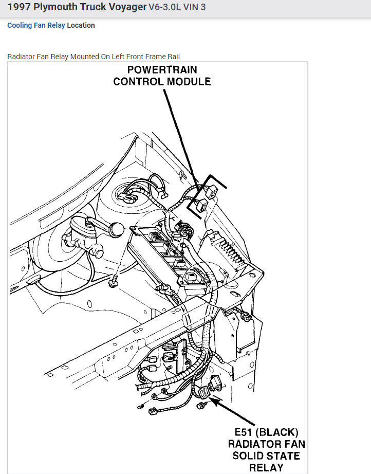

We're trying to replace the fan relay but can't figure out where it goes.
Saturday, December 6th, 2008 AT 3:01 PM
SQM
MECHANIC
6,383 POSTS

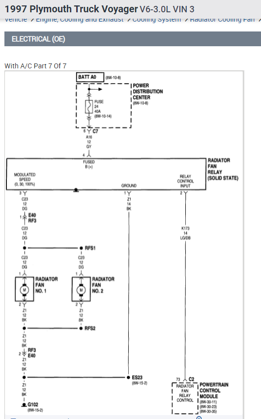

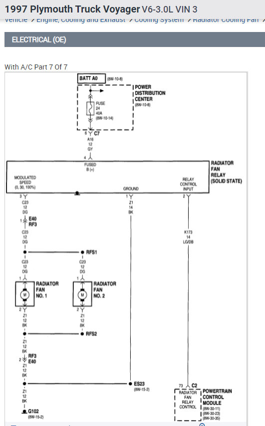

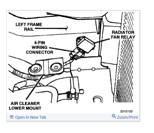

The radiator cooling fan relay is located next to the radiator on the right had side frame rail (if you are facing the engine).
I have attached the location diagram for your reference.
