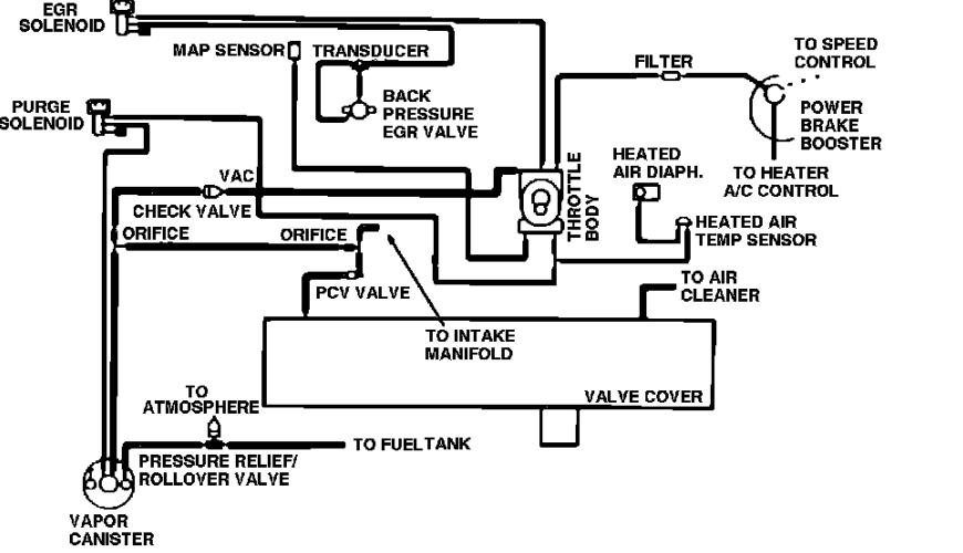

A vacuum hose is unattached. It is causing the engine to die when it is idling. Where does the hose attach?

https://images.2carpros.com/forum/automotive_pictures/99387_Graphic1_508.jpg
https://images.2carpros.com/forum/automotive_pictures/99387_Graphic2_247.jpg

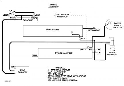

I need a diagram for the vacuum lines om a '95 Plymouth Voyager 4cyl. 2.5 ltr

Look for an emissions sticker under the hood first. That will have the correct one for your application. If it's missing, your best bet is get a copy of the manufacturer's service manual through the dealer.
I can try to handle a few of the specific items. I have a '95 Grand Caravan, but it has a 3.3L engine.

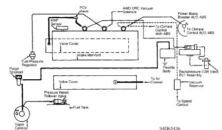

Our vacuum hoses have dry rotted and fallen apart. I need a diagram so I can replace them.

https://images.2carpros.com/forum/automotive_pictures/62217_33_3.jpg

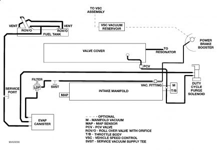

While replacing my valve cover gasket several vacuum lines broke and or fell appart and I am looking for a picture of where each line hooks back up. I have a cluster of 4 lines that come from the passenger side of the van and they all need replaced. Any guidance would be great as the local Dodge dealer told me that they have no pictures or diagrams to help me.

Here is the correct one. Let me know if you need anything else.
