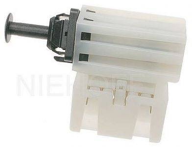

My brake lights will not go off. I fond the fuse panel but I can't see where the brake light fuse is. What can I do? Where can I find a picture of the fuse panel so I know which one it is?

You need to be looking for the brake switch, so you can replace it. Not to pull the fuse, that will make it not working. The switch is located at the very top of your brake pedal. It looks like this
https://www.2carpros.com/forum/automotive_pictures/55316_sl321111_1.jpg
