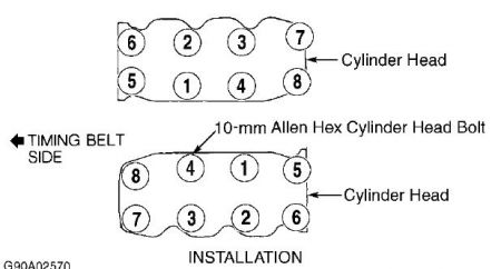

Need to know what the torque settings and tighting pataren for the heads is if you could please help me out

Torque is 70 ft pds sequence is......
