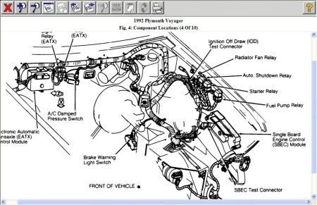

There is no voltage going to my electrical fuel pump, the pump works, but I can't locate where the relay switch or fuse is

Fuel pump relay see below there's no fuse for the fuel pump also test the ASD relay
