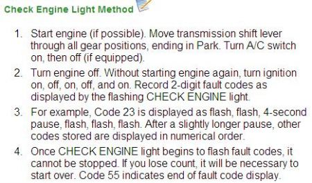

You may be able to access some codes by the check engine lite method. You cycle the key till the dash lites come on, no further. On-off, on-off, on, then the check engine lite starts flashing, you count the flashes to get the codes.

Ok. It flashed like three times and then pause until it reached 18 times. Any idea on what that means then?

https://www.2carpros.com/forum/automotive_pictures/170934_plymouth_codes_1.jpg
Hi, I can't tell by your description, maybe the above info will help? Your looking for two digit codes.

That helped a little, but not exactly following it for a two digit code. It is doing:
flash long pause
flash long pause
flash short pause
flash, flash, flash, flash quickly
flash long pause
then the five flashes to end the code.

There are codes for the charging system, didn't see that in your description. I did see a possible code 14, for the map sensor? I did'nt see a code for electrical issues. When trying to use flash codes, sometimes, I have to do it several times, to make sure. Sometimes I get lost trying to count all the flashes.
