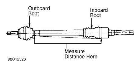

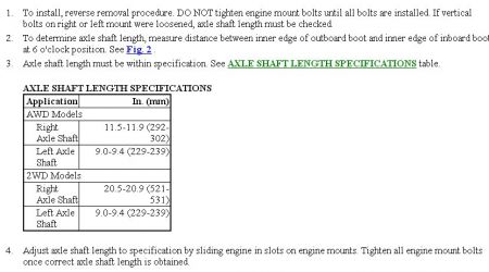

i have replaced trans mount,front center mount,and bracket,and ofcourse,the left side axle assy.it seems that every time i go over a large bump,or turn real sharp,it breaks the left side axle,its almost like the axles to short,because it breaks from the axle shaft,to the input shaft to the tranny,any help?

You have to loosen the mounts, center the engine by using measurements from the axleshaft.
https://images.2carpros.com/forum/automotive_pictures/30961_shaft1_2.jpg
https://images.2carpros.com/forum/automotive_pictures/30961_shaft2_2.jpg
Then torque them back down.
