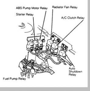

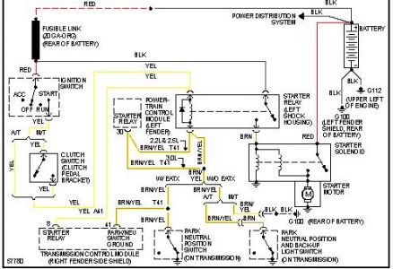

1993 Plymouth Sundance 4 cyl Automatic 487000 miles
when try to start with key i get nothing but when i ump the starter wires the starter turns . i am on a fix income so i can' afford to have some fix it for me please help

Hi, I can give you the relay location and wiring diagram. You need to check the voltage circuits at the relay, key in the crank position, two terminals should be hot. Did you try cranking in neutral?
