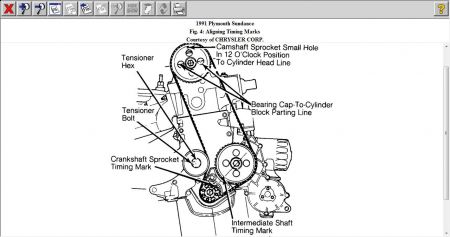

where are the timing marks and where do they need to be to replace a timing belt
Sunday, July 26th, 2009 AT 3:33 PM
MECHANIC
75,992 POSTS
Put the engine no.1 piston on its compression stroke/TDC and line everything up as you see below
