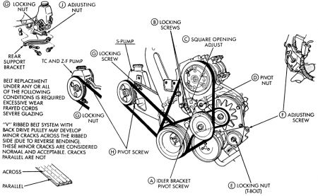

How do I tighten my altenator belt

Tighten the adjusting bolt (F) to adjust the belt tension. To measure the belt tension, a belt tension tool will be needed, such as Chrysler Special Tool Kit C-4162.
