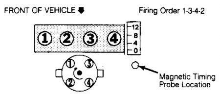

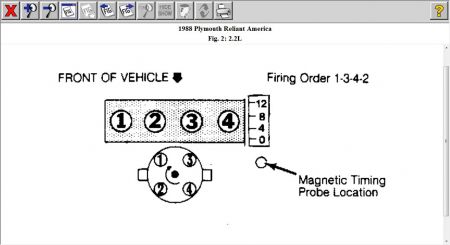

Which is the#1 spark plug on my 1988 plymouth reliant 2.5? Which of the 4 plus is number one when I install them? Thank you. Frank.

Frank They run 1 2 3 4 from passenger side to driver's side.
