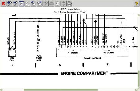

The fuel pump stopped working, checked all fuses and they are ok. Checked for power coming to the pump and there is no power what else could this be. The pump is only a couple of months old.

Inspect and test the power module, it powers the fuel pump from pin out no.6 dark green and black wire-
https://www.2carpros.com/forum/automotive_pictures/12900_power_module_2.jpg
