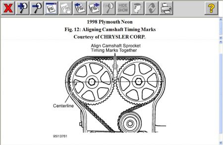

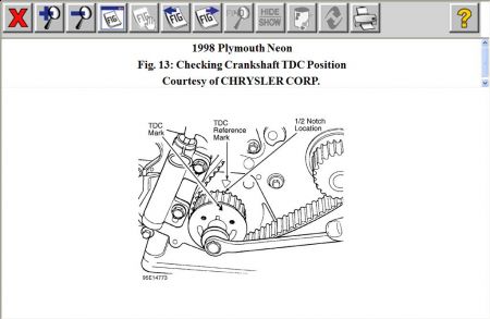

what position are the dowl pins on the cam shafts when both cam sprocks are aligned with the crank shaft at top dead center at number 1 piston

2.0L DOHC or SOHC ??
Dec 30, 2009 at 6:13 PM
THECRAWFORDS4
2.0 dohc
Dec 30, 2009 at 6:28 PM
  • CAR REPAIR CONTRIBUTOR
  • 75,992 POSTS
See below
https://images.2carpros.com/forum/automotive_pictures/12900_cam1_4.jpg
https://images.2carpros.com/forum/automotive_pictures/12900_cam2_5.jpg
