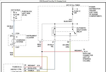

Im not getting power to electrical system checked all the fuses theyre all good repaired some wires under the hood

Do you need a wiring diagram?

Yes I need a wiring diagram where can I get one

Charging:
Starting:
