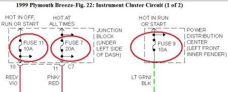

it stop woking do you have a guess what could be the broblem

Start by checking these 3 fuses. If they are good, remove the cluster from the dash, and check all connectors.
I suspect bad cluster.
