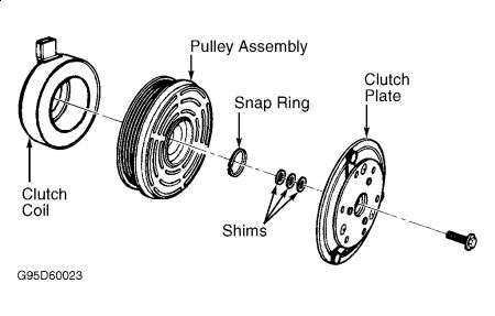

How do I remove the front plate from the ac compressor. (not a c171)

CLUTCH ASSEMBLY Removal Discharge A/C system, using approved refrigerant recovery/recycling equipment. Remove A/C compressor. Using a spanner wrench or clutch holder, remove clutch plate bolt. Discard bolt. Thread an 8-mm bolt into clutch plate, and remove clutch plate and shims. Remove pulley outside snap ring. Remove pulley assembly. See Fig. Disconnect clutch coil lead. Install Shaft Protector (T89P-19623-FH) over compressor shaft. Install 2-jaw puller on compressor. Carefully tighten puller to remove clutch coil from compressor. DO NOT use air-powered tools when removing clutch coil
https://images.2carpros.com/forum/automotive_pictures/99387_Graphic1_421.jpg
