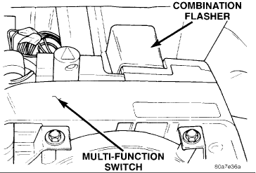

Where is the turn signal flasher located on a 97' Breeze?

1997 Plymouth Breeze L4-2.0L VIN C Combination Flasher Location
https://images.2carpros.com/forum/automotive_pictures/12900_tsf_1.gif
COMBINATION FLASHER The flasher is mounted to the back side of the multi-function switch. To gain access the upper steering column cover must be removed. Refer to Steering and Suspension/Steering/Steering Column Cover removal procedures. The flasher can be removed by pulling it forward. The flasher is serviced separately from the multi-function switch. The flasher is black in color for ease of identification.
