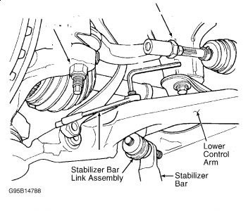

How to replace the outside tierod end
Monday, September 21st, 2009 AT 9:51 PM
BMRFIXIT
MECHANIC
19,053 POSTS
set E brake
Jack the remove tire
loosen lock nut between outer and inner tie rods
remove tie rod end hold down nut on the steering knuckle
remove tie rod from knuckle
