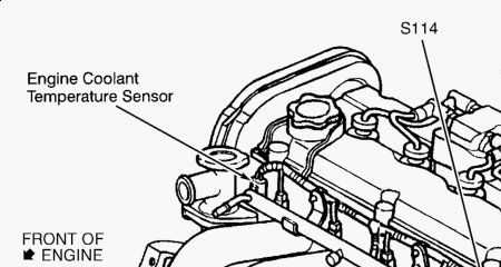

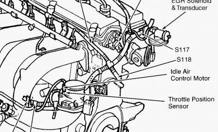

What causes the engine to shut off just prior to stopping or when I decelerate and push in the clutch. It will not idle until the engine temperature rises. Idle rpm's are at 750, it seems to be heat sensitive because it does not shut off in summertime temperatures. The thermostat has been changed. Thanks
Friday, September 28th, 2018 AT 5:34 PM (Merged)
MERLIN2021
  • 17,250 POSTS
If it is more temperature related check/replace the ECT(engine coolant temperature) sensor near the thermostat housing. The IAC(idle air control) can do the same thing, but will do it hot or cold.
https://www.2carpros.com/forum/automotive_pictures/62217_ect_Breeze_1.jpg
https://www.2carpros.com/forum/automotive_pictures/62217_iac_2.jpg
