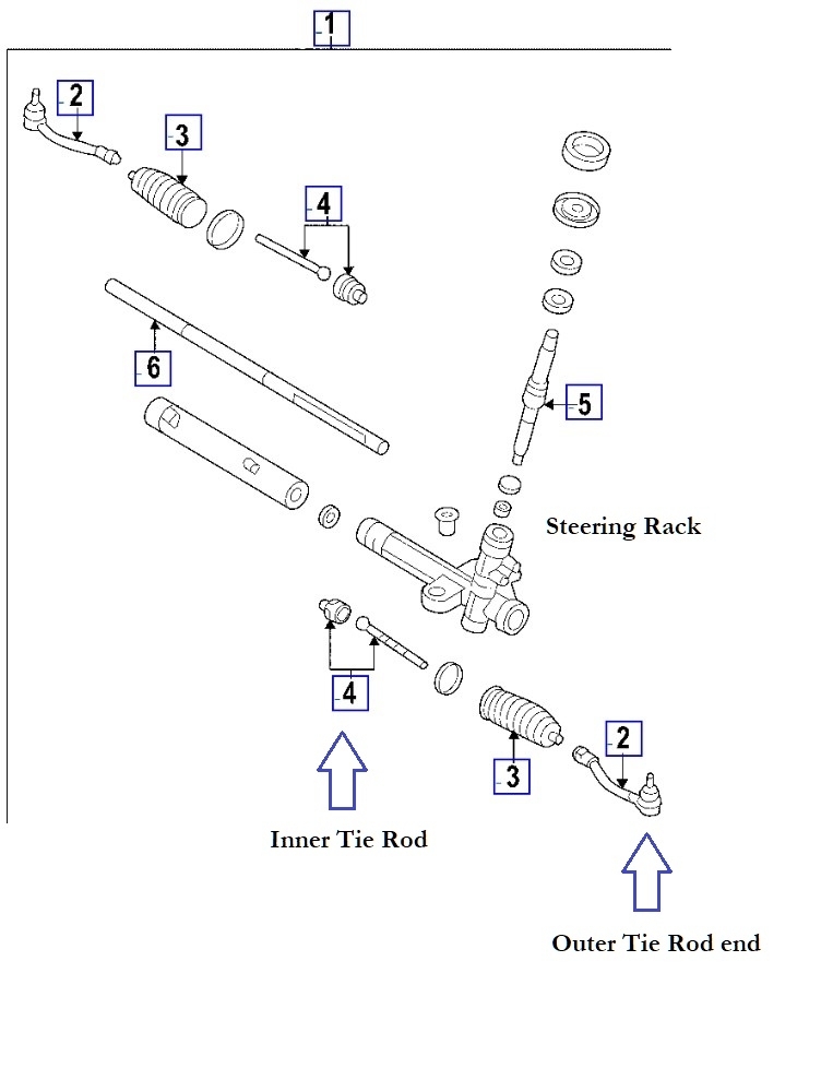

Hello, I would check for any play/movement in the tie rod end, either at the steering knuckle or the inner end which goes into the steering rack. Sounds like you may have a bad tie rod end. Im not sure the noise you heard, with it not happening again, Id start with checking the steering rack components. With no play at 6 and 12, which could indicate a bad ball joint, but you have some good direction already. You should be able to shake the wheel back and forth at 3 and 9 and be able to see the movement in the outer tie rod end, if not, suspect the inner section. I have a diagram here that shows the setup, I will post it here in a minute.

So this is the steering rack diagram. It shows the inner and outer tie rod ends. They do list a part number for both the inner and outer tie rod ends, and we used to replace just the inner tie rod on some makes/models, just depends on what was available and it required a special tool to go inside the rack and tighten the inner. Or in most cases the entire steering rack was replaced. The outer tie rod you can replace by counting the amount of turns it takes to get it off and put the new one the same amount and only a slight adjustment had to be made to the alignment in most cases as well.
Here a guide to help, let us know what you find.
https://www.2carpros.com/articles/tie-rod-end-replacement/

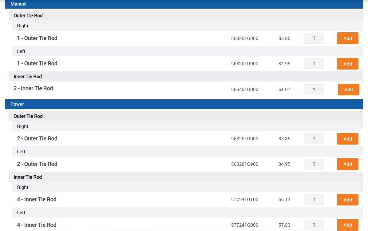

These are the oem part numbers for the tie rod ends if needed,

Thanks AL514, I have replace the outer tie rod and there is no play now.
