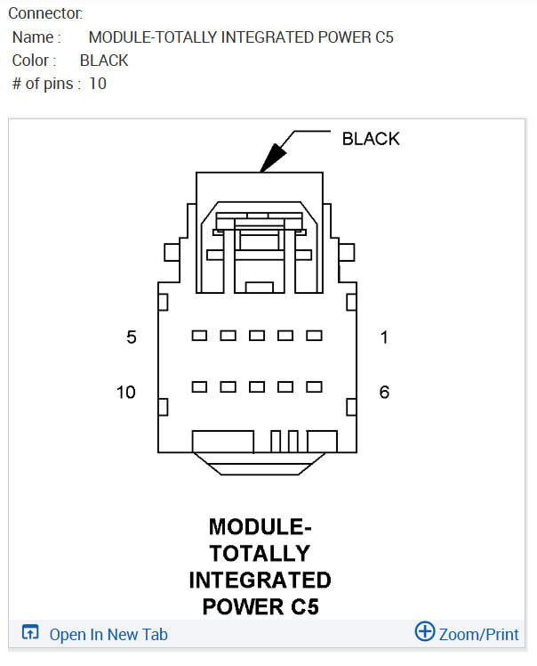

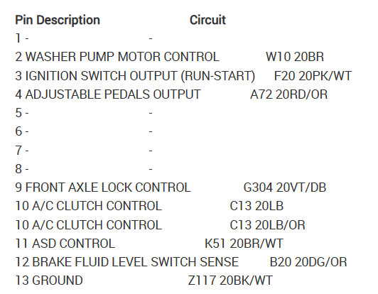

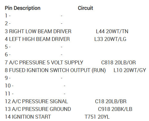

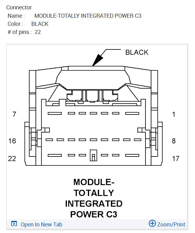

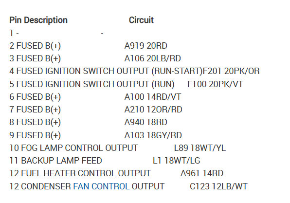

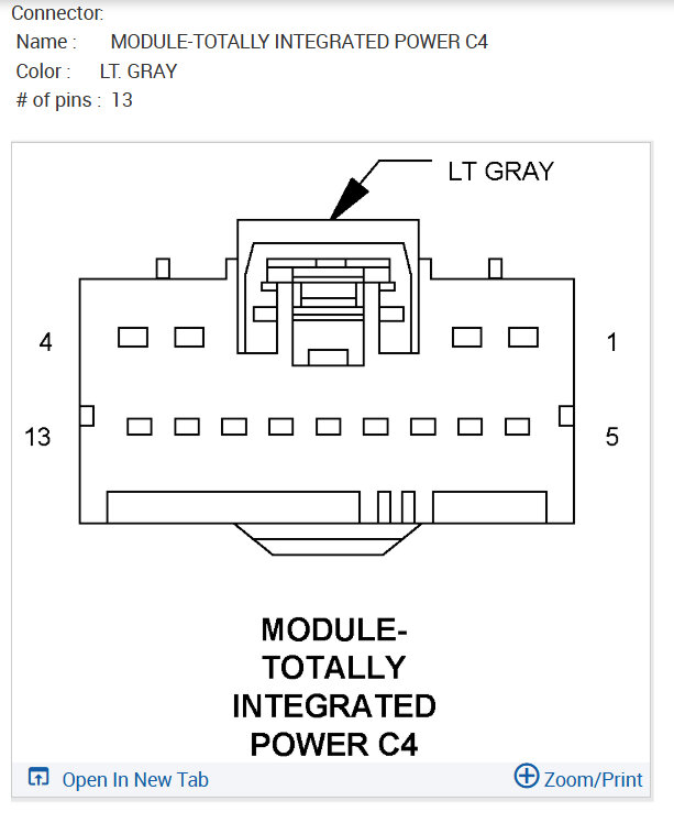

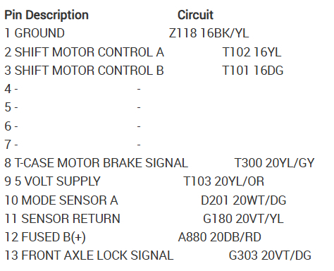

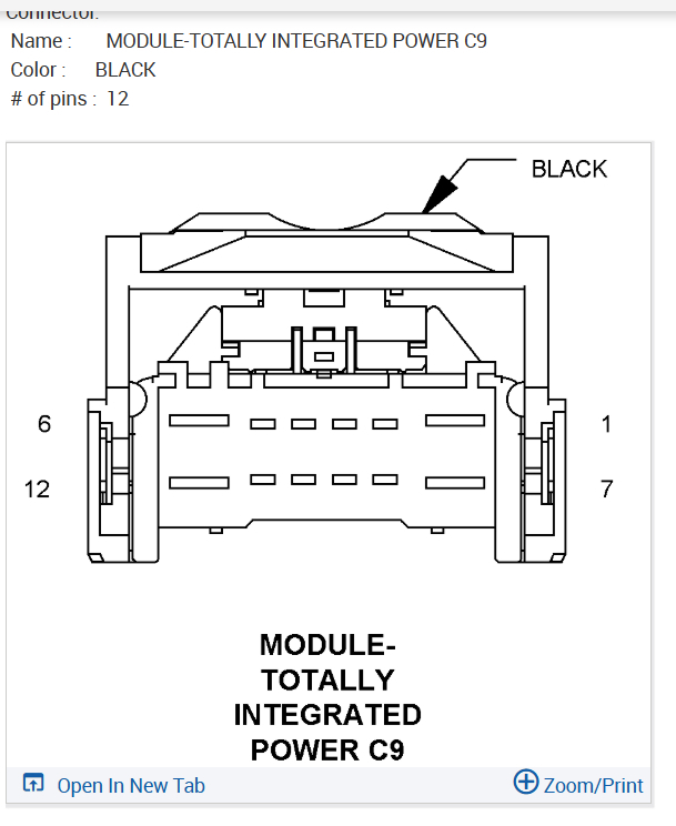

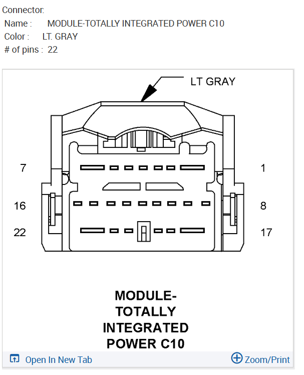

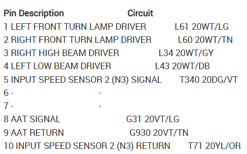

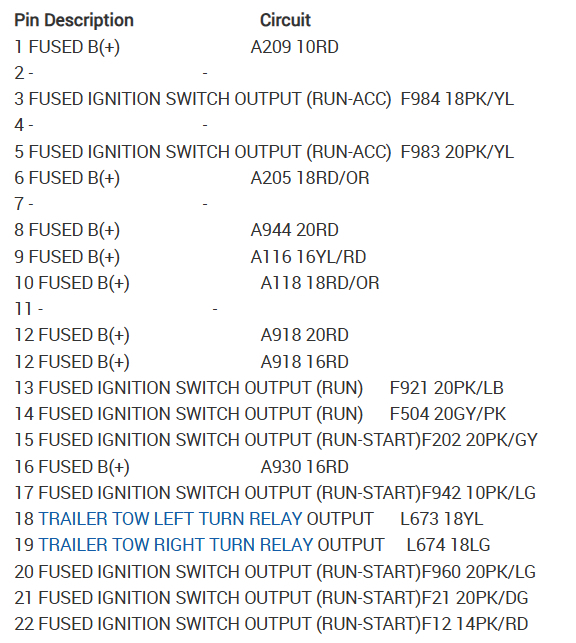

pinout charts for the back of the TIPM needed?
2007 DODGE RAM
200,000 MILES • 5.9L • 6 CYL • TURBO • 2WD • AUTOMATIC
TROY CLEMMONS

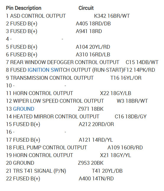

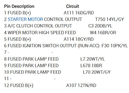

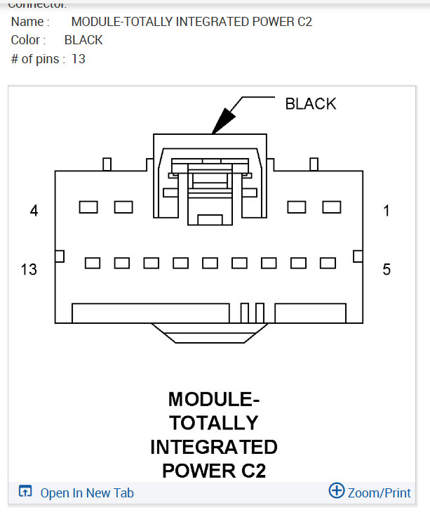

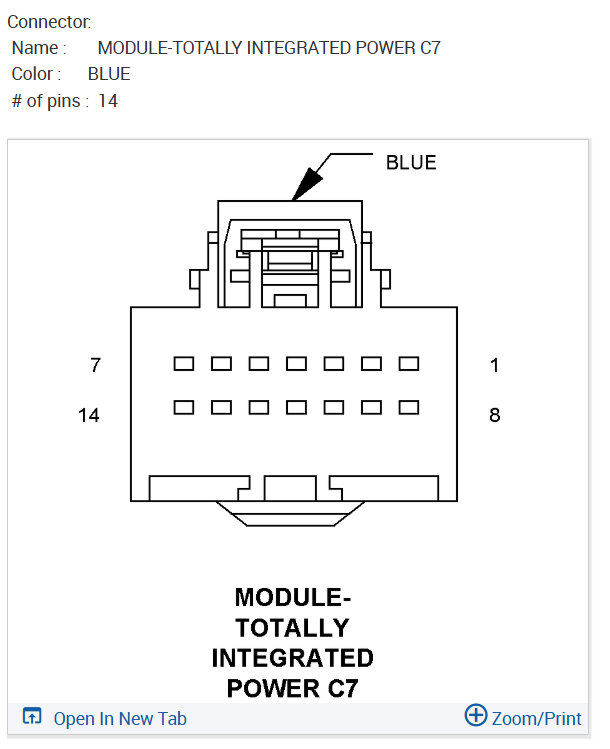

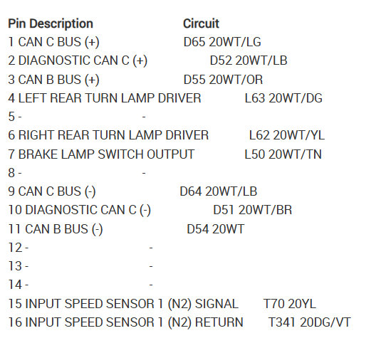

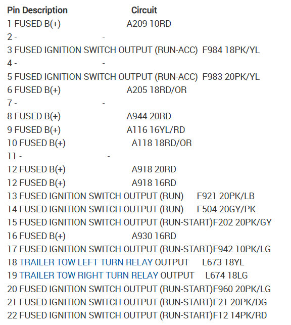

transmission stop shifting, governor pressure goes to 60 lbs when in drive.
Mar 23, 2025 at 7:18 AM
  • 54,503 POSTS

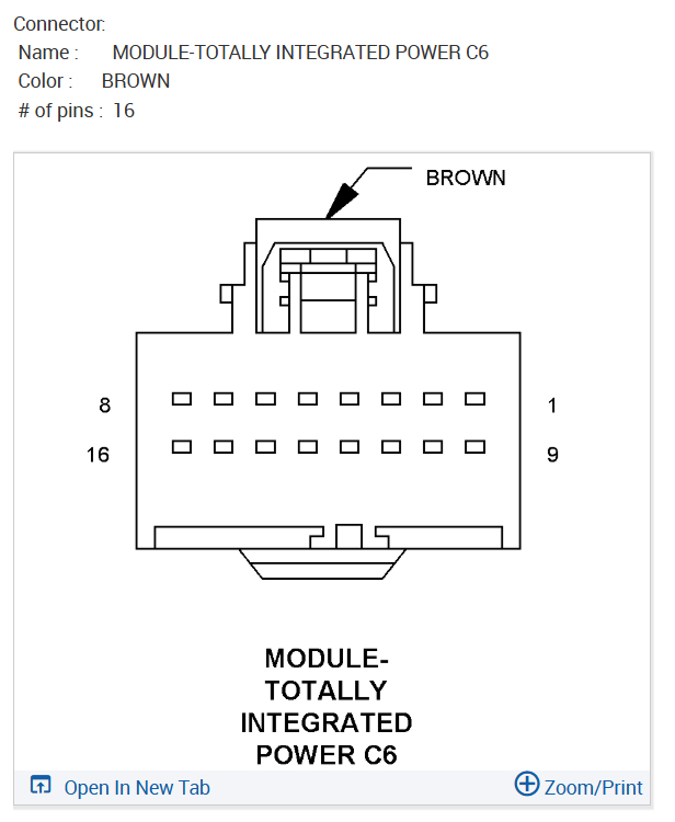

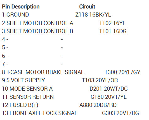

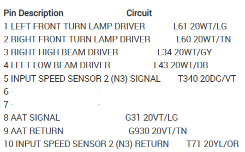

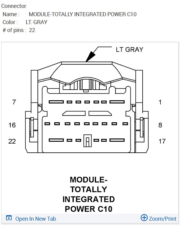

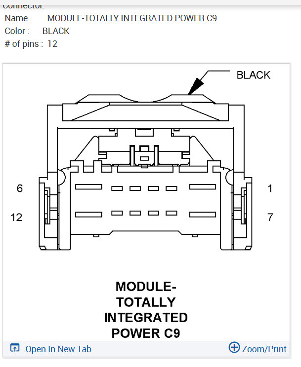

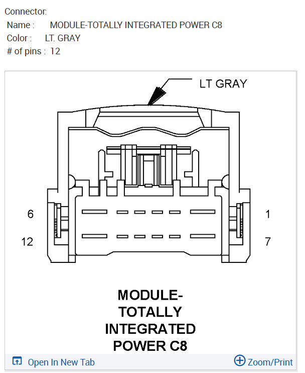

Hello Troy,
It seems like the governor pressure is low FYI so the transmission might be toast. Here are the TIPM pinouts for the connectors. Check out the images (below). Let us know how it goes.
Mar 23, 2025 at 11:26 AM
