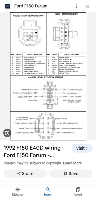

i put a transmission from a 2005 or 2003 Expedition in my truck listed above, but i had an extra sensor or something that i had to cut from the 2003 harness and put on mine but. the speedometer shows me going 50 when I'm going 5 and it's not shifting right
are the pinouts coming from the transmission in different spot than my harness so it's not reading right, idk.
i need a pin out for a transmission harness for the Expedition and my truck listed above if that's possible.

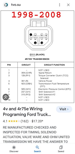

I went through the wiring schematics. In 2003, the Expedition had one engine option, a 4R70W. The wiring schematic is two pages long for this vehicle. However, I had to cut each pic in half to make them readable. Therefore, the first 4 pics below are from the Expedition.
Pic 5 is related to the 2000 F150. There were two different possible transmissions. One is a 4R70W and the other is a 4R100. I'm not sure what your truck had originally. Here is another concern. The wiring schematic for a 2000 F150 with the 4R70W is only one page. Therefore, something is different. Pics 6 and 7 are the wiring schematic for the 2000 F150 4R70W. The last two pictures are of the 2000 F150 4R100 transmission.
At this point, I would start by determining the OEM transmission model your truck came from and then start trying to match wiring colors for confirmation. Then, determine which connector was cut from the Expedition, and locate the wire colors on the schematic to determine what you cut and if it exists on the truck's harness.
Also, if you still have the transmission you removed from the truck, lay it side by side with the replacement and compare connectors.
