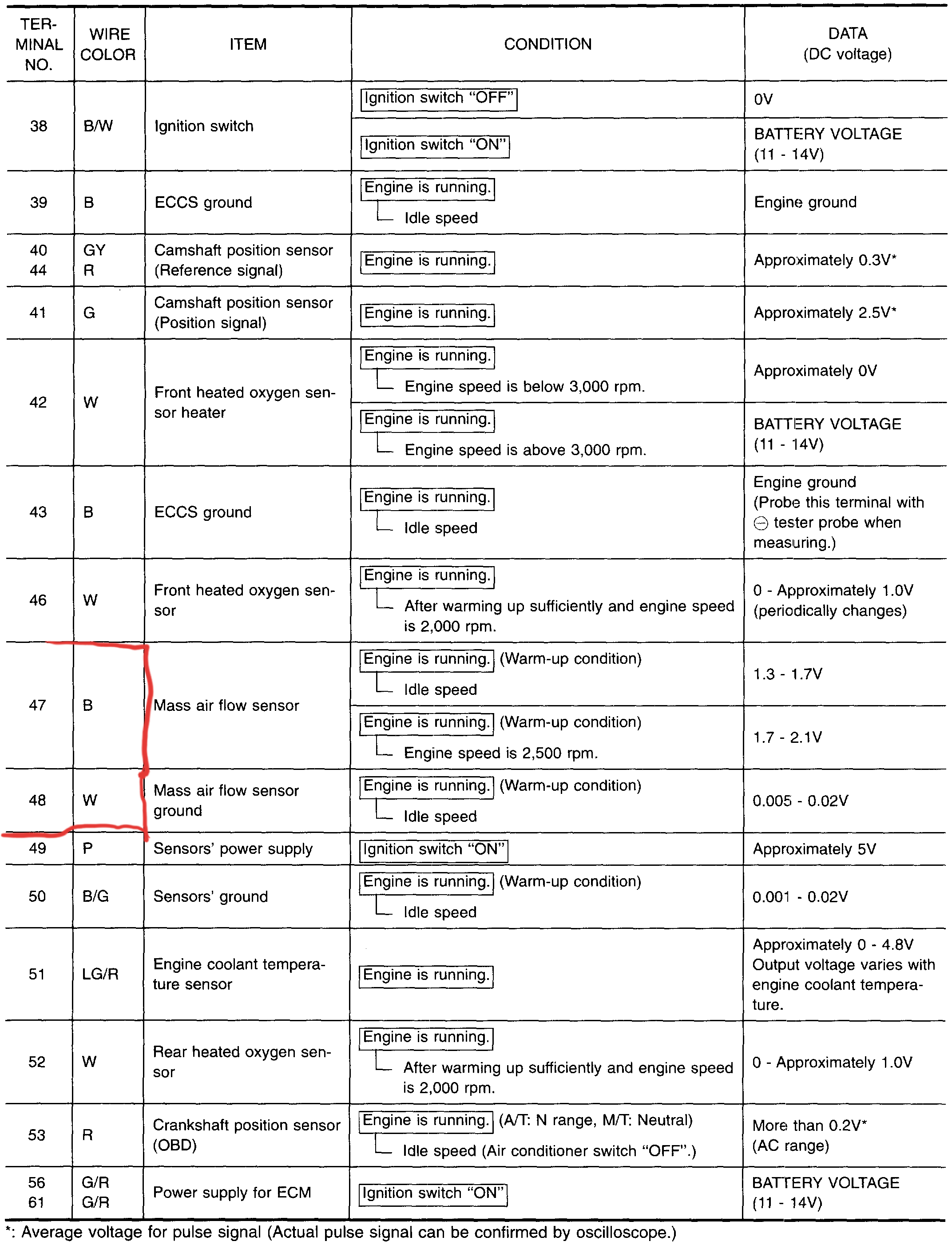

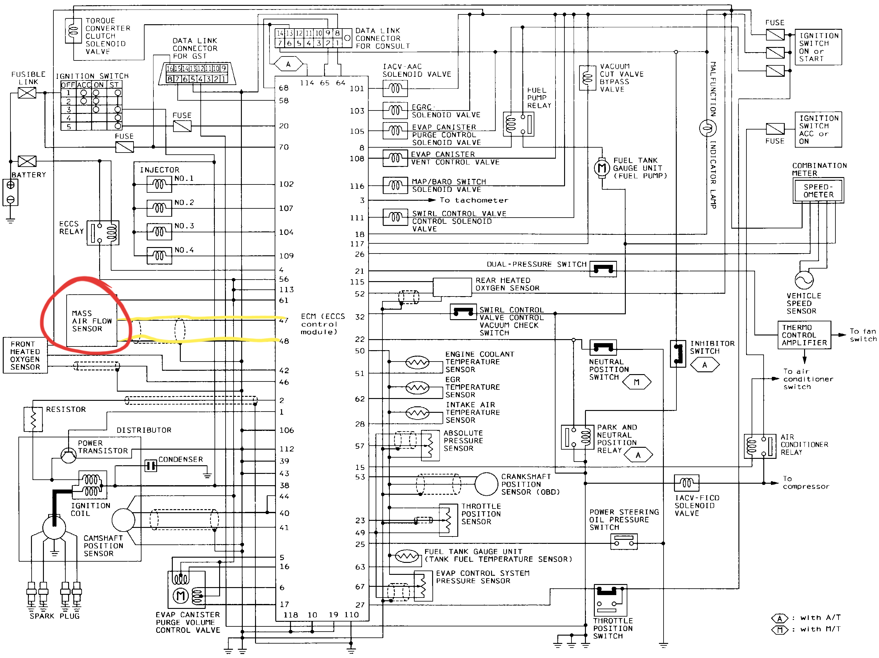

need pin location on PCM/ECM for circuit numbers 47/48 and to include wire color.

Hello and welcome to 2CarPros. The circuit you are talking about looks like the mass air flow sensor circuit? Is this correct?

Yes, sir MAF sensor.

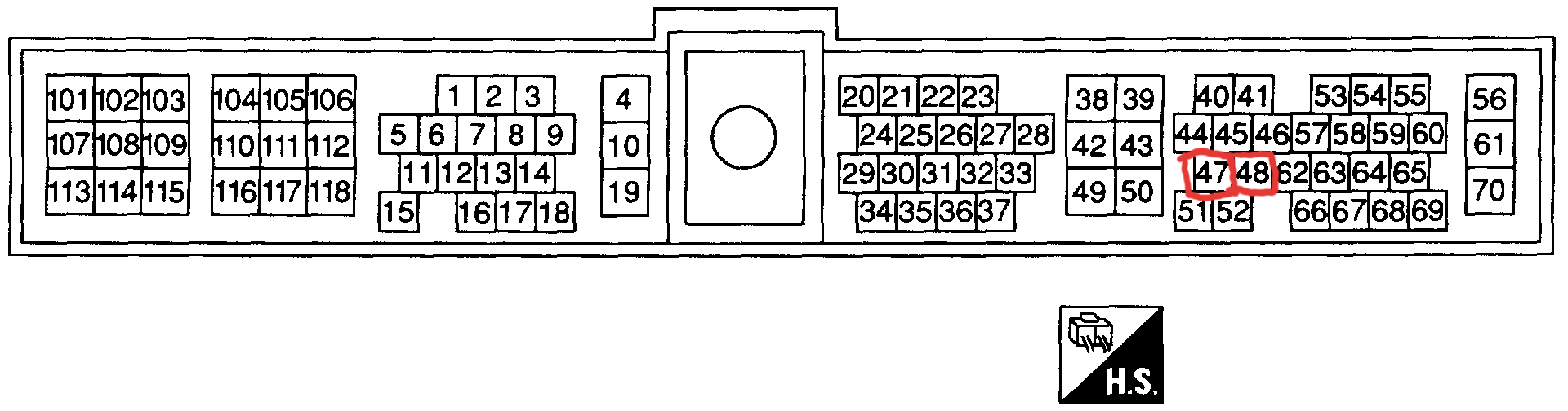

Can you show me exactly by looking at the PCM wheres those 2 pins at?

Here you go. Let us know if the information helped.

Thank you very much, Sir this is what I needed. again thank you.
