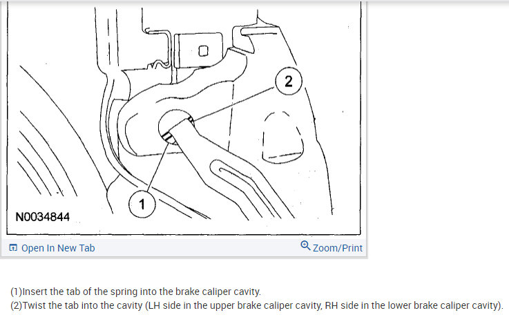

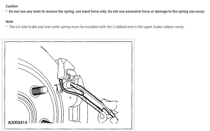

Here is a tutorial showing what is involved on how to change front brake pads and brake rotors:
I've attached picture steps below on how to change the front brake pads and rotors on your vehicle. Hope this helps and thanks for using 2CarPros.

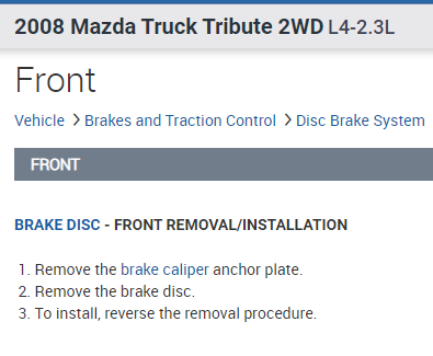

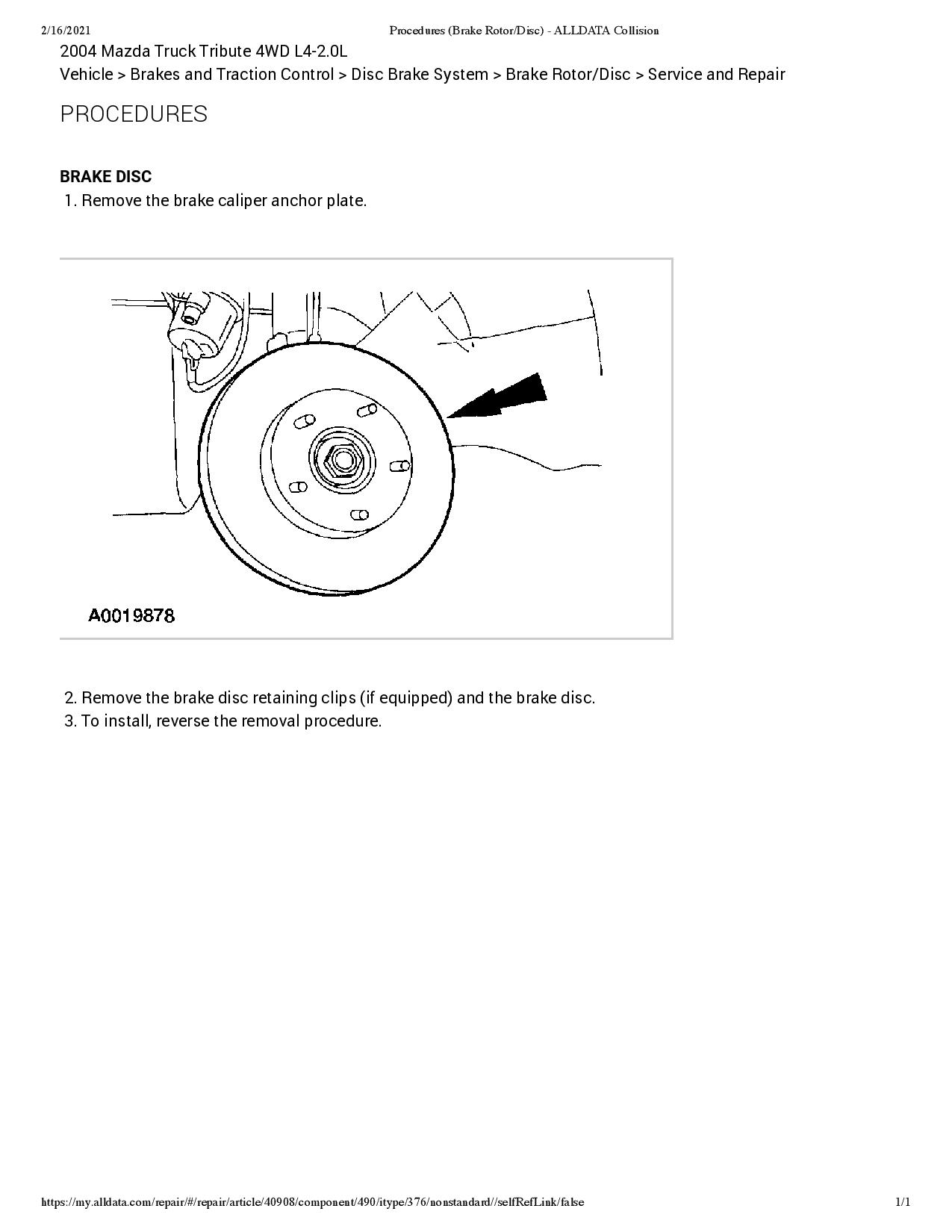

Hard to remove the rotors, not sure if I have to remove the center botl or just hammered hard.
Monday, February 22nd, 2021 AT 11:09 AM (Merged)
HMAC300
  • 48,601 POSTS
You'll have to pull the caliper and claiper bracket off then if the rotor doesn't want to come off, spray soeme pentrating oil around the center and hit it with a hammer to knock it loose. Do not hit any wheel studs. If it doesn't comeoff you'll have to wait and try again.

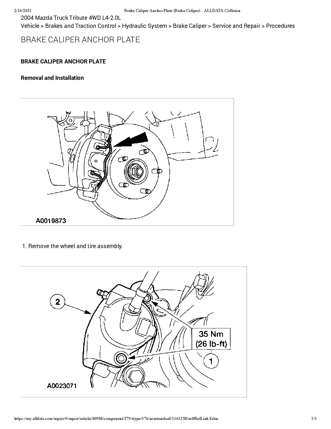

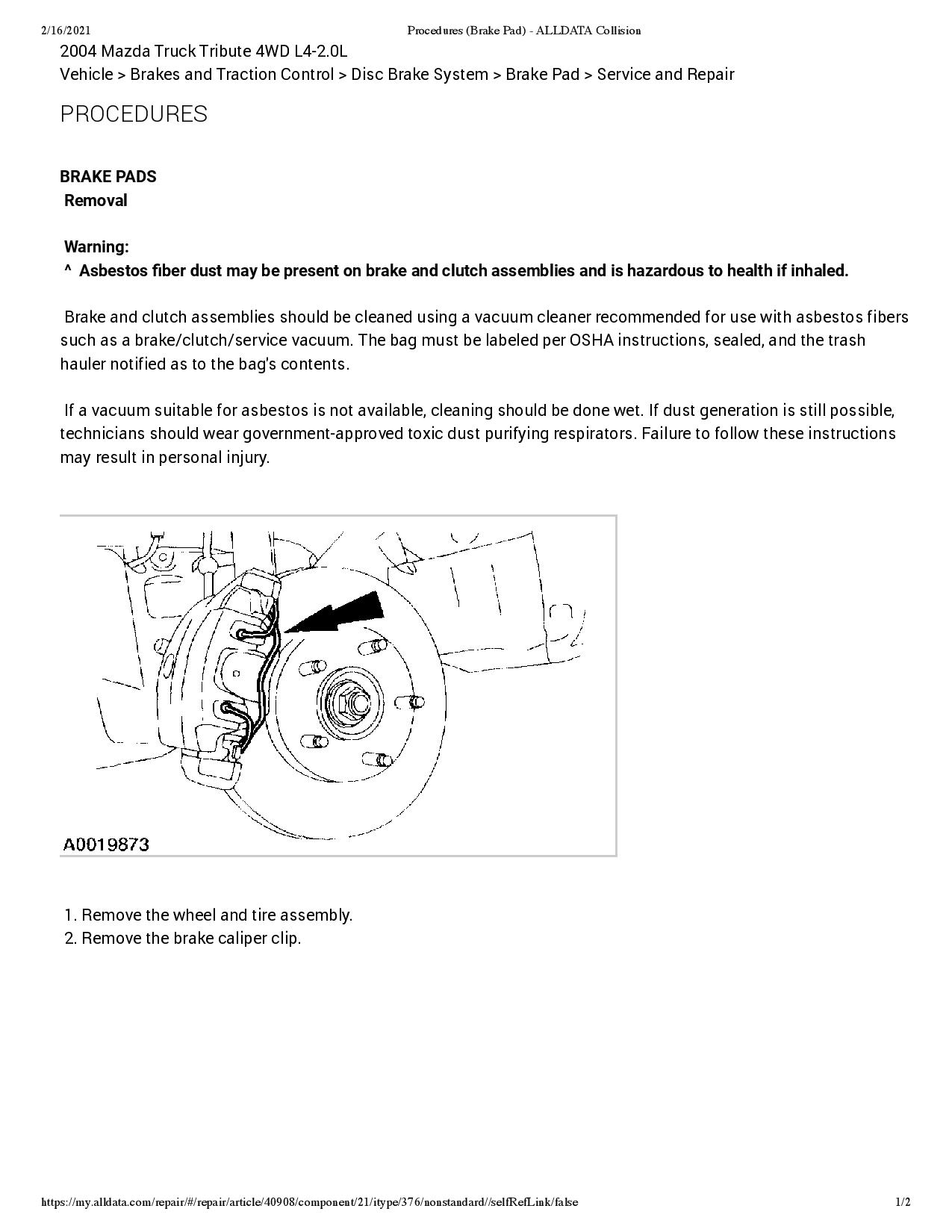

We recently purchased the vehicle listed above only to find out that it burns 3/4 quart of oil every 500 miles. After completing oil consumption testing to prove to Mazda it was burning oil they suggested replacing the PCV valve. So far this seems to have fixed the problem. My question is the brake warning light is on can you help me do front brakes?
Monday, February 22nd, 2021 AT 11:10 AM (Merged)
JOETECHPRO
  • 705 POSTS
Hey sayler,
No problem we can provide you with the front brake service instructions.
First i would direct you to the 2CarPros front brake repair guide. This contains a lot of useful information on this repair and is a great place to start.
Below i have also attached the specific repair instructions for front brake pads and rotors for your vehicle.
Hope this helps, let is know if there is anything else you need.
Regards, Joe

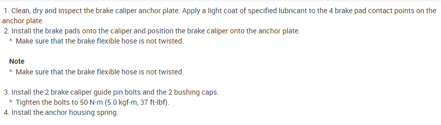

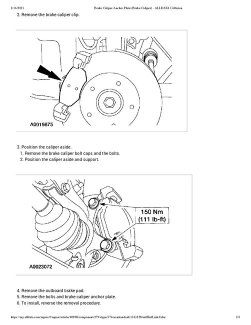

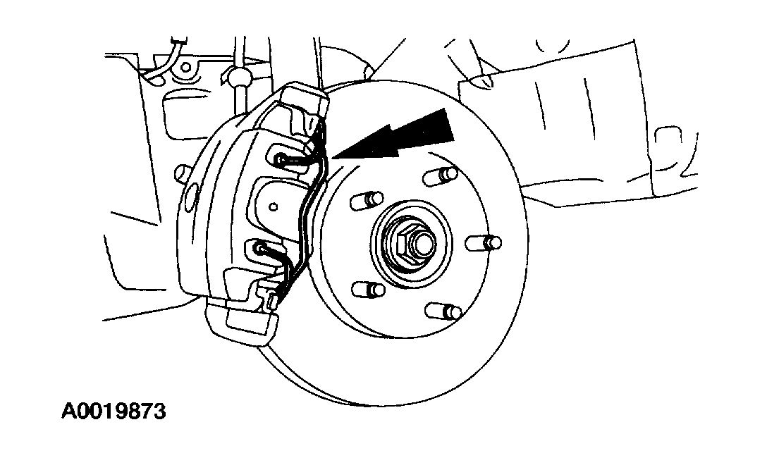

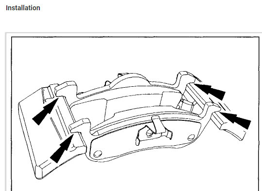

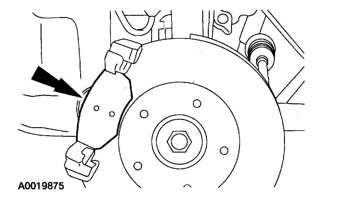

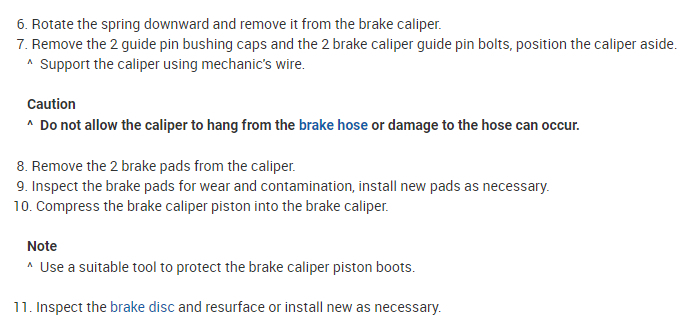

DAVE SR
  • 2005 MAZDA TRIBUTE
  • 98,000 MILES

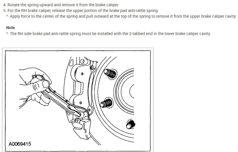

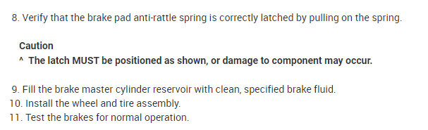

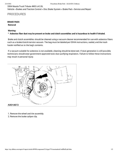

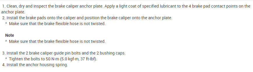

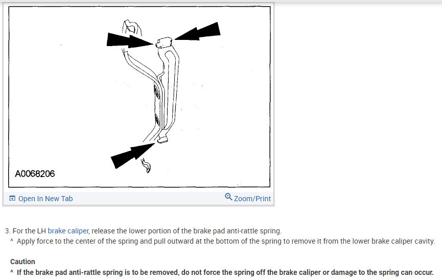

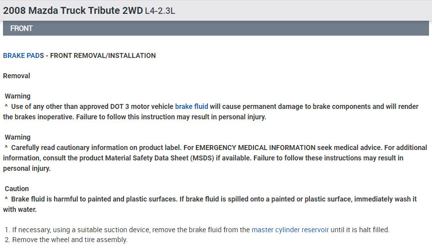

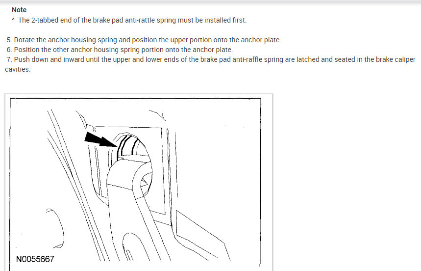

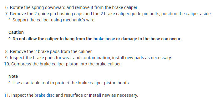

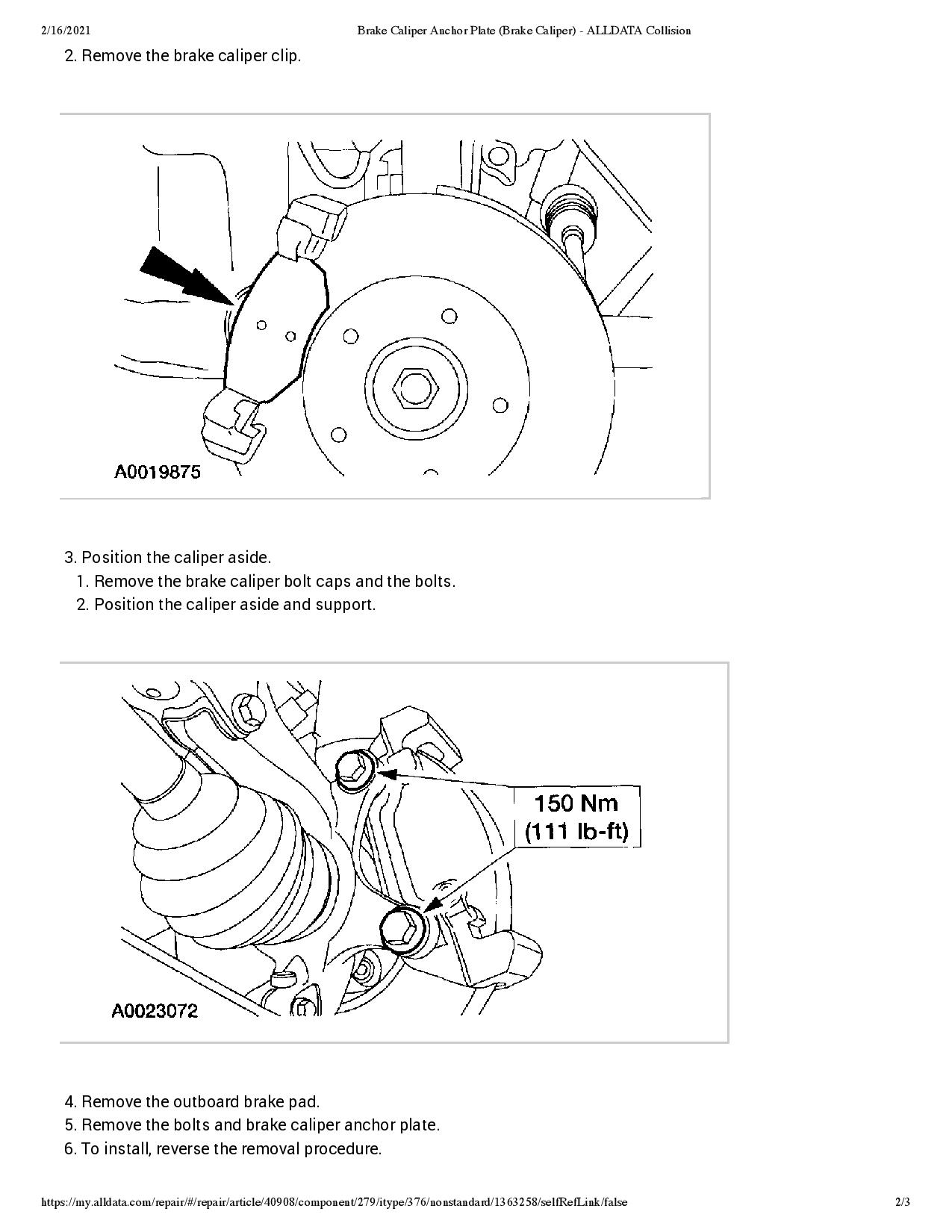

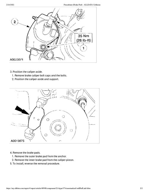

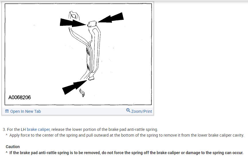

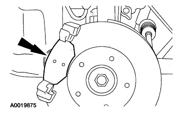

After a rain storm my car feels like the brake are not working well at all I need to replace the pads
  • 110,194 POSTS
Replacing front brakes isn't too hard to do. You can expect to get approx 25,000 miles from a set of pads, but that is based on the driver.
First, here is a link that shows how to replace brakes and rotors in general. You can use this as a guide.
_________________________________

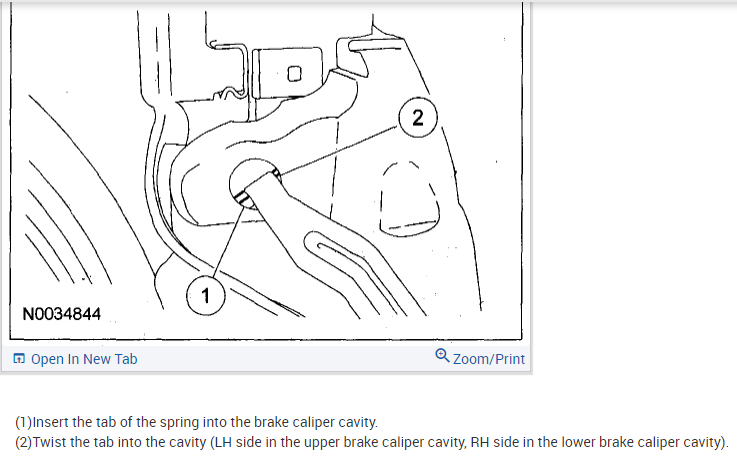

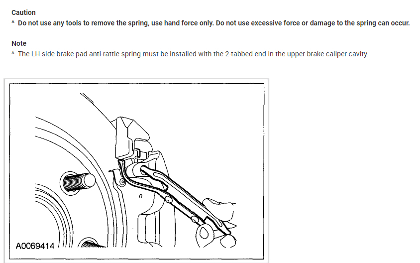

Here are the directions specific to your vehicle. The attached pics correlate with the directions.
2005 Mazda Truck Tribute 2WD L4-2.3L
Front
Vehicle Brakes and Traction Control Disc Brake System Brake Pad Service and Repair Procedures Front
FRONT
BRAKE PADS - FRONT
Removal and Installation
Pic 1
1. Remove the brake caliper clip.
2. Remove the brake caliper dust boot caps.
3. Remove the brake caliper guide bolts.
Caution: Do not allow the brake caliper to hang by the flexible hose.
Note: It is not necessary to remove the brake caliper jounce hose.
4. Remove the brake caliper from the anchor plate and support the brake caliper to the vehicle.
pic 2
5. Remove the brake pads.
Remove the outer brake pad from the anchor plate.
Remove the inner brake pad from the brake caliper piston.
6. To install, reverse the removal procedure. Lubricate the brake caliper guide bolts with silicone grease.

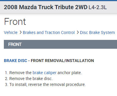

Rotor
Front
Vehicle Brakes and Traction Control Disc Brake System Brake Rotor/Disc Service and Repair Procedures Front
FRONT
BRAKE DISC - FRONT
1. Remove the brake caliper anchor plate.
2. If reinstalling the brake disc, reference mark the brake disc to the wheel hub studs.
3. Remove the brake disc.
4. Clean the brake disc and wheel hub mating surfaces of foreign material and debris.
5. To install, reverse the removal procedure.
