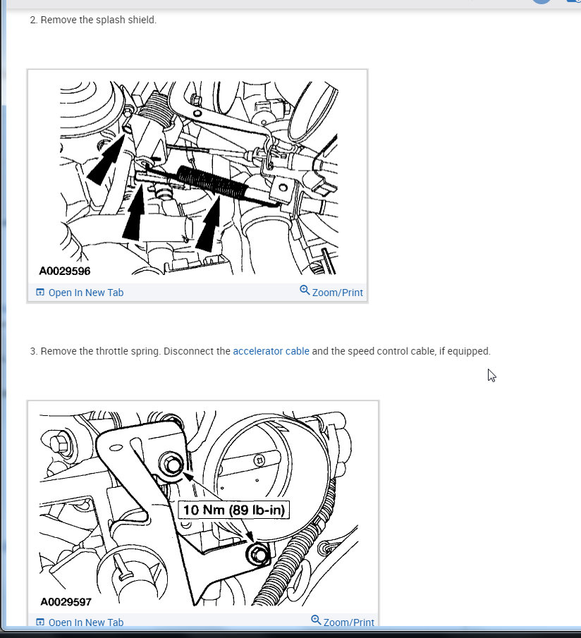

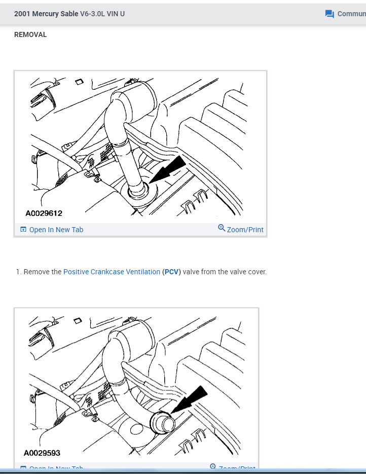

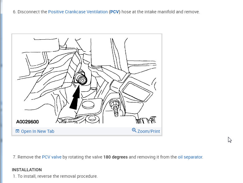

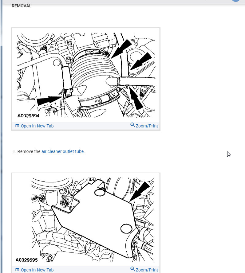

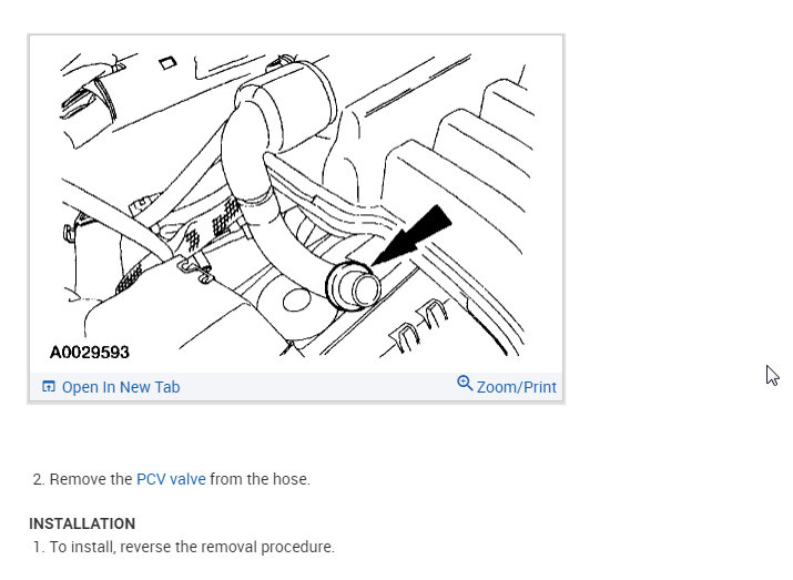

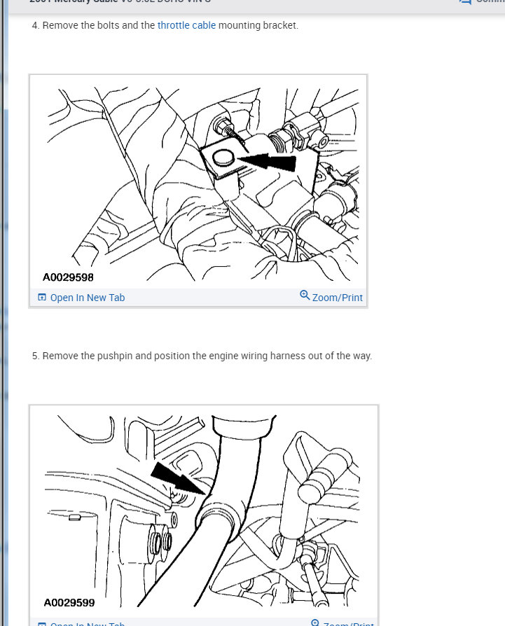

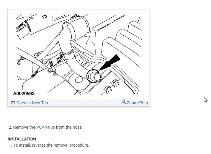

Trying to locate the PCV valve to replace it with a new one.
Monday, September 21st, 2020 AT 3:21 PM
MECHANIC
18,907 POSTS
I assume you have the 3.0L DOHC and not the SOHC. The DOHC location is a little more buried then the SOHC motor.
I attached both processes depending on what you have. The last two pages are the SOHC. The prior are for the DOHC.
