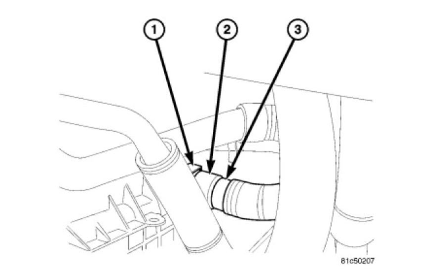

Please help. Where is the PCV valve located on this engine? I can’t find it!

The PCV is on the valve cover. It is screwed into the valve cover.
I attached a picture and the procedure for you.
1. Remove positive crankcase ventilation (PCV) hose (3) from PCV valve (2).
2. Unscrew PCV valve (2) from valve cover (1).
Image (Click to make bigger)
