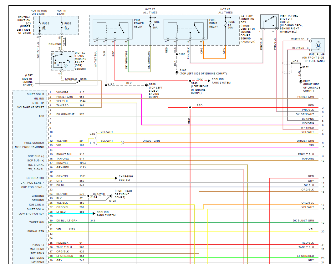

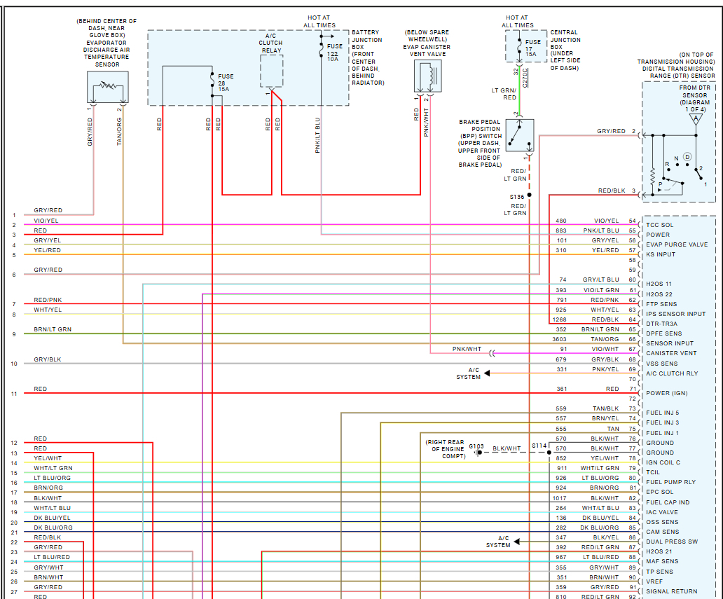

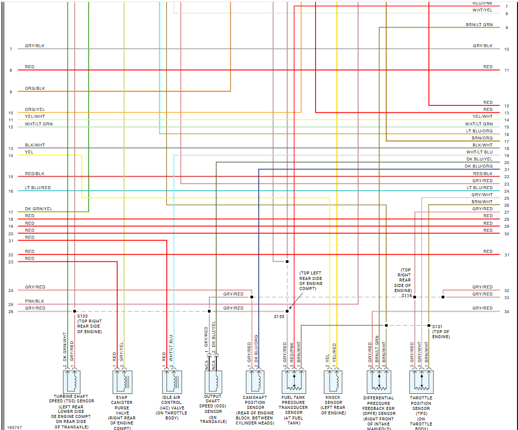

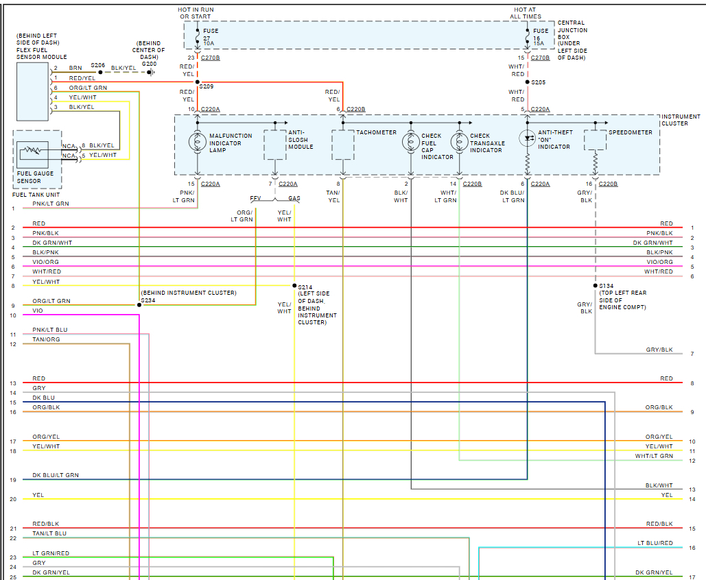

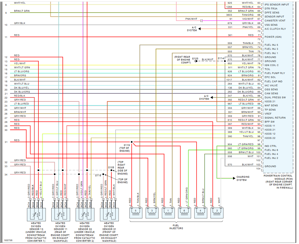

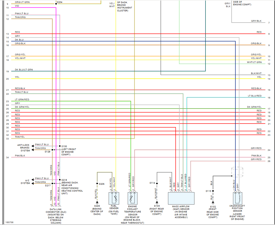

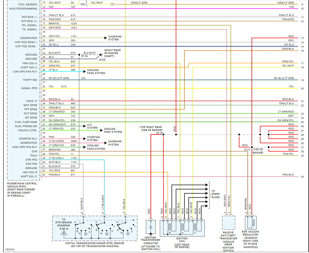

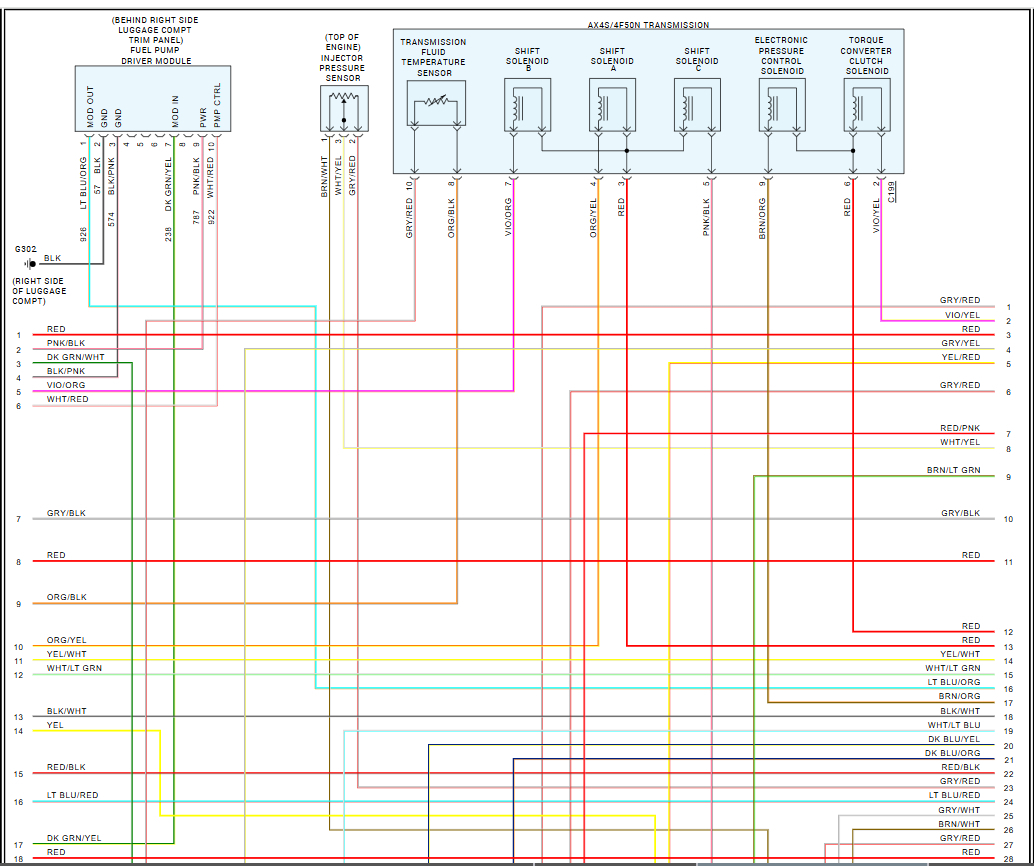

My car won’t start. When you turn the key, it instantly blows the pcm fuse. Must be a short in the wiring? I need the wiring diagram.
Jun 20, 2026 at 5:42 PM
  • CAR REPAIR CONTRIBUTOR
  • 54,436 POSTS
I have seen a shorted ignition coil/fuel injector do this as well FYI. Here is a guide to help you figure out what is going on with the PCM wiring below.
https://www.2carpros.com/articles/how-to-check-wiring/
Let me know how it goes.
Jun 20, 2026 at 7:03 PM
  • 54,436 POSTS
Try unplugging the ignition coils and replace the fuse and turn the key on to see what happens.
