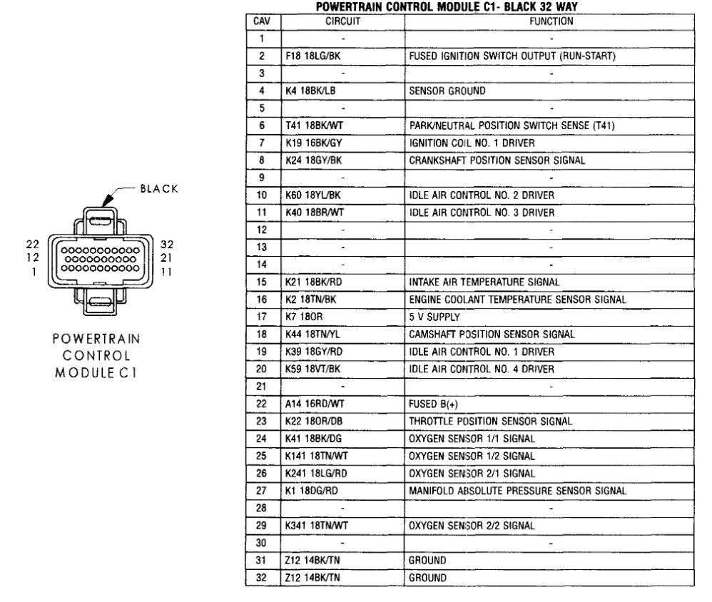

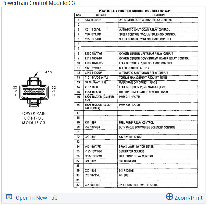

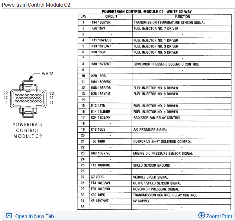

PCM plug and pin printout needed?
MARK W. HENSLEY
MEMBER
2001 DODGE DURANGO
5.9L
V8
4WD
AUTOMATIC
270,000 MILES
May have some same colored wires in wrong position on white plug.
Wednesday, May 7th, 2025 AT 10:14 PM
KEN L
MASTER CERTIFIED MECHANIC
55,281 POSTS
Sure, here are the PCM connector views and the wiring identification. Check out the images (below). Let us know if you need anything else.
