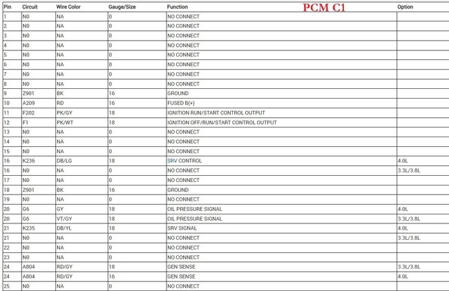

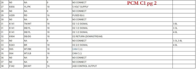

C1 (black) pin out diagram.

Hello, you only need C1 pinout? This is for 3.3L Flex Fuel vehicle? Just want to make sure thats correct.

This is for the C1, I'll post the rest just in case you need them.

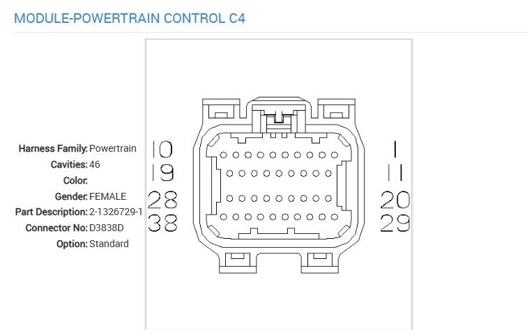

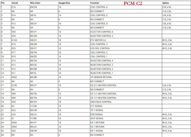

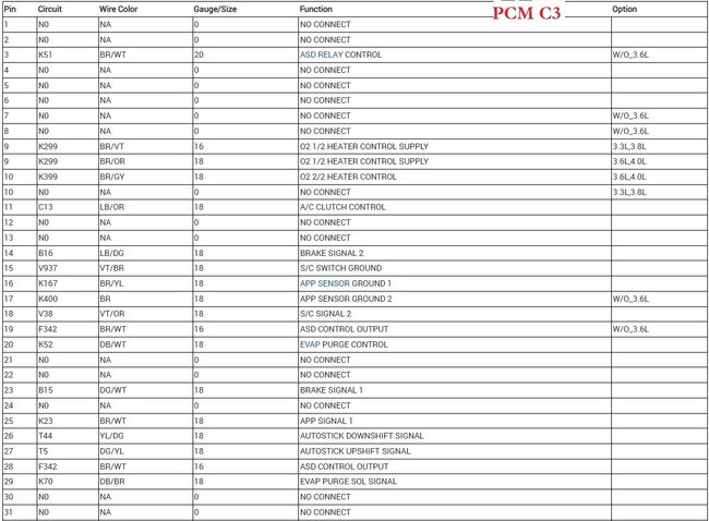

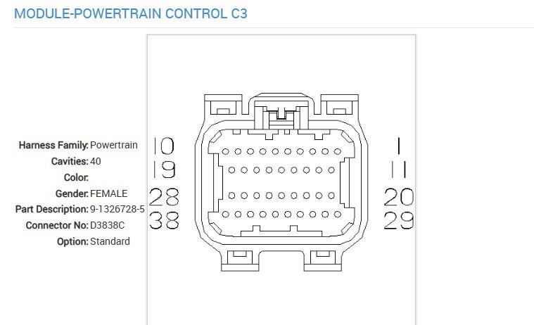

Here are the rest of the PCM connector pinouts, C2, C3, C4.
