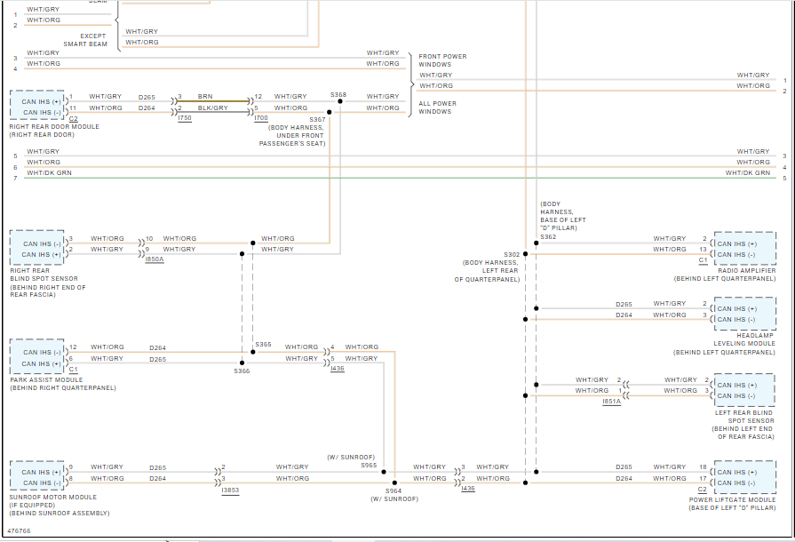

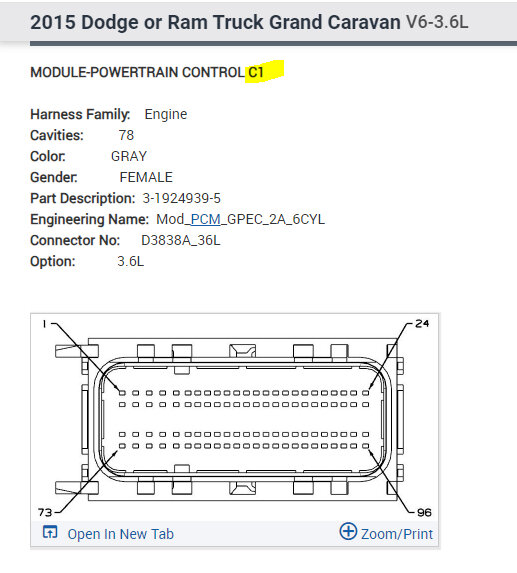

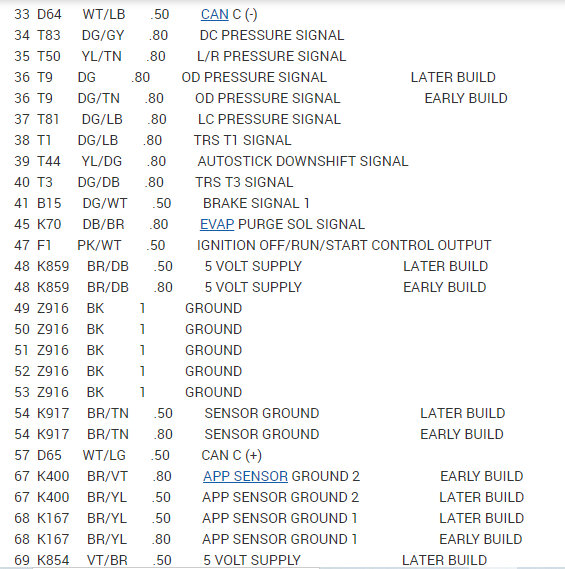

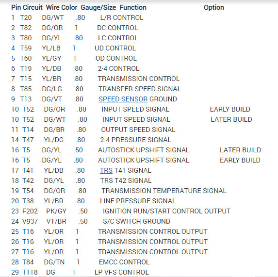

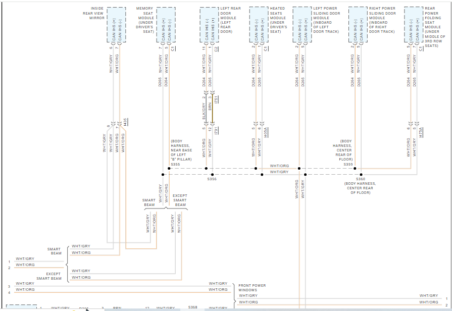

having communication issues and need to find a pin out of the PCM.
Jan 31, 2024 at 6:21 PM
  • CAR REPAIR CONTRIBUTOR
  • 110,193 POSTS

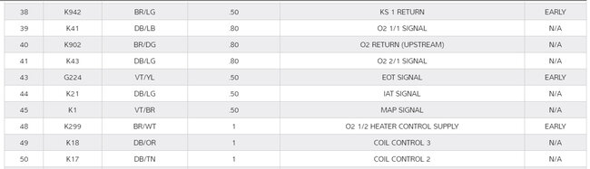

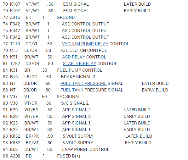

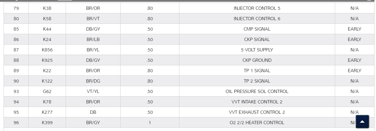

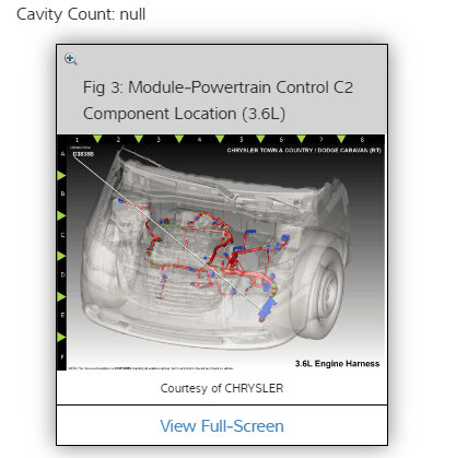

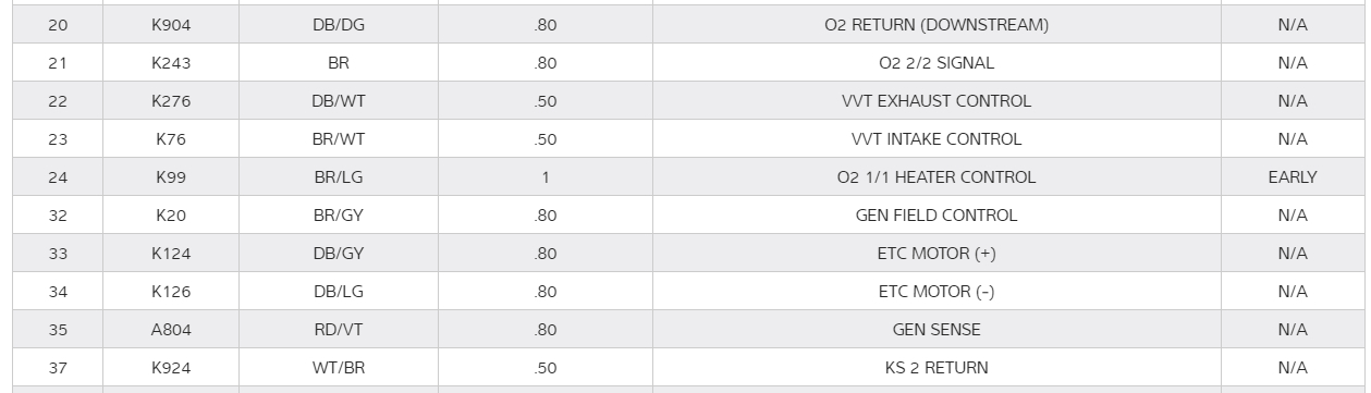

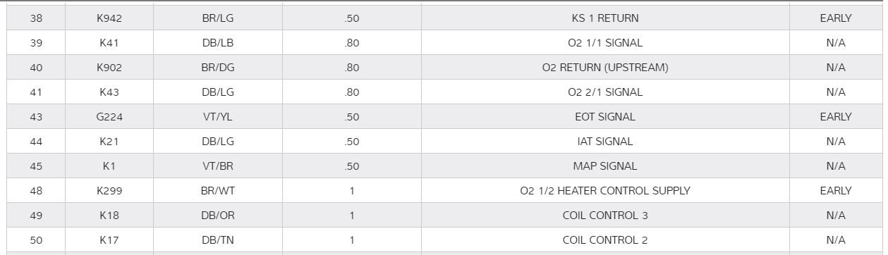

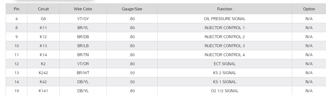

As far as the connector pinout, I attached it below. After the connector view, there is a legend for the pins, wire type/color, gauge, and pin numbers

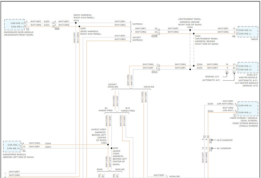

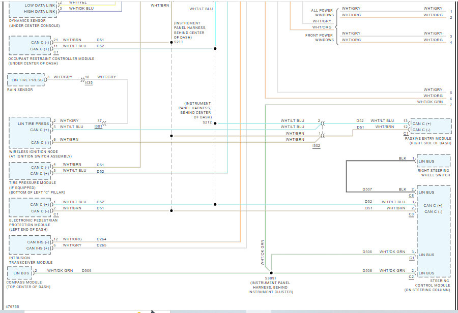

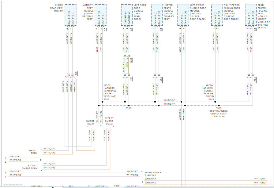

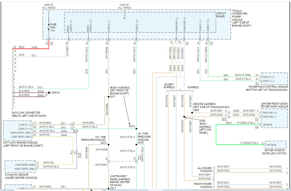

I'm not sure what is happening. Based on your post, it sounds like you should be looking at the information bus schematic (computer data lines). If that is the case, let me know.
Jan 31, 2024 at 6:51 PM
FRENZA2012
If you have them to I'd love to have them! What a wonderful website, 13 years in the industry never heard of this site.
Jan 31, 2024 at 9:36 PM
  • 110,193 POSTS
The first questions were answered in 1999. LOL (25th anniversary this year). Regardless, I'm glad the information helped.

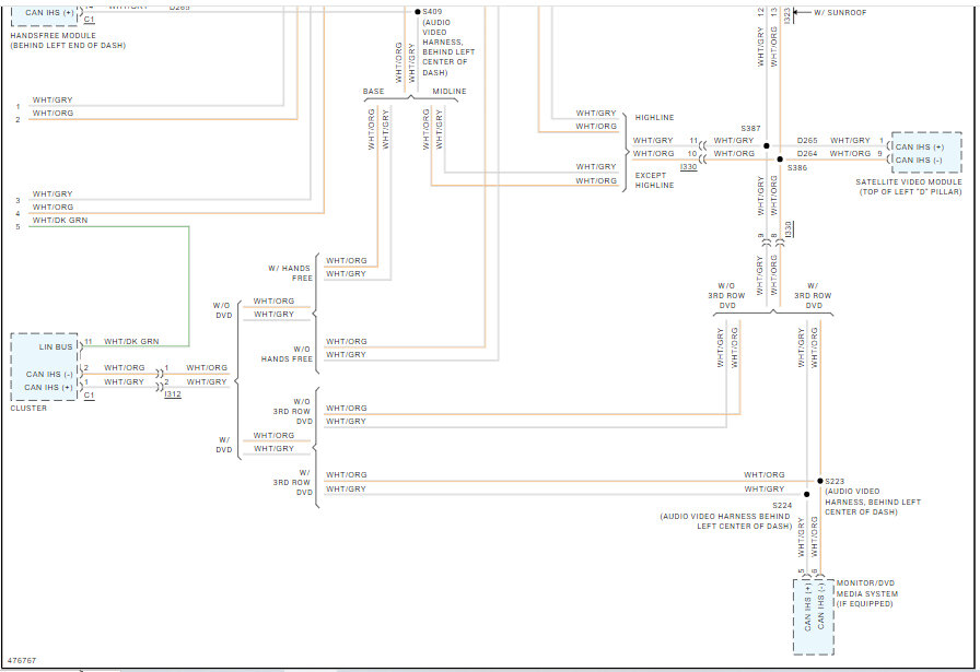

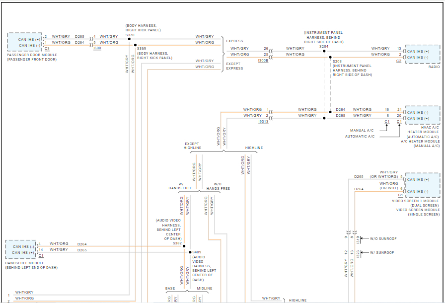

As far as the information bus, I attached the wiring schematics below. There were three pages of schematics. I had to cut each page in half to make them readable. I did overlap them so you can follow from one to the next.
Take good care of yourself and feel free to come back anytime in the future.

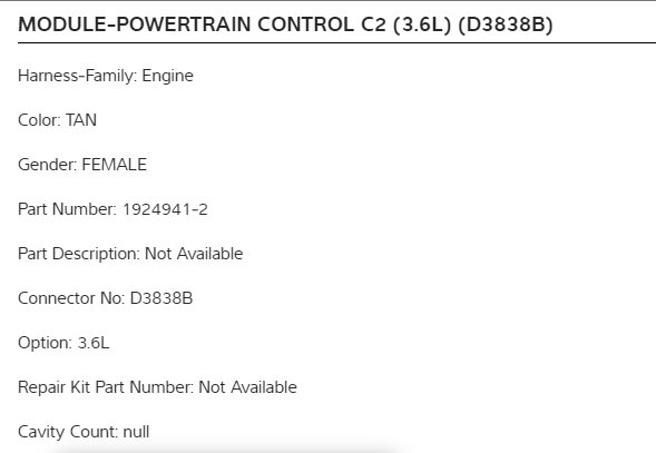

Hey Joe,
Sorry for the delay, we haven't had a chance to work on it yet until now.

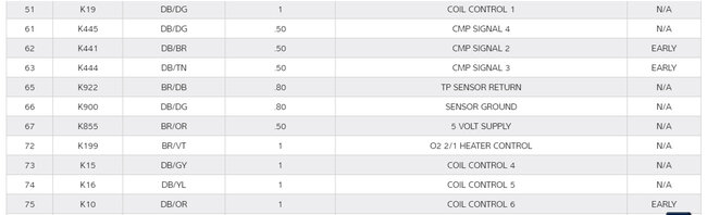

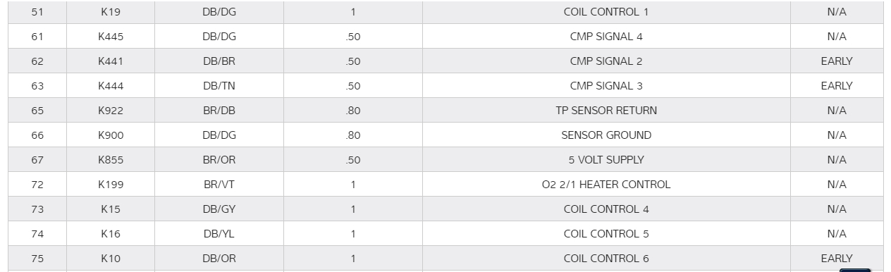

Would you happen to have the second connector for the PCM? So far, your help is greatly appreciated!
Thank you!
Feb 19, 2024 at 10:12 AM
  • 110,193 POSTS

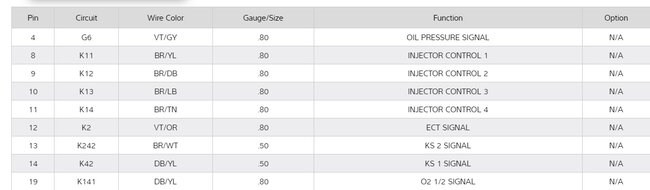

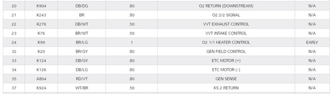

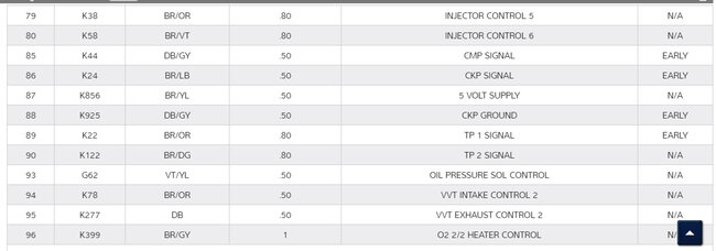

For some reason, the connector view itself isn't available. The only thing, in two different manuals, that I could find was what each pin does with no orientation.
I don't know if it will help but take a look and let me know.
