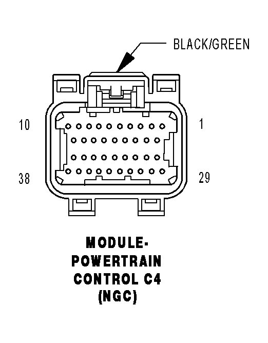

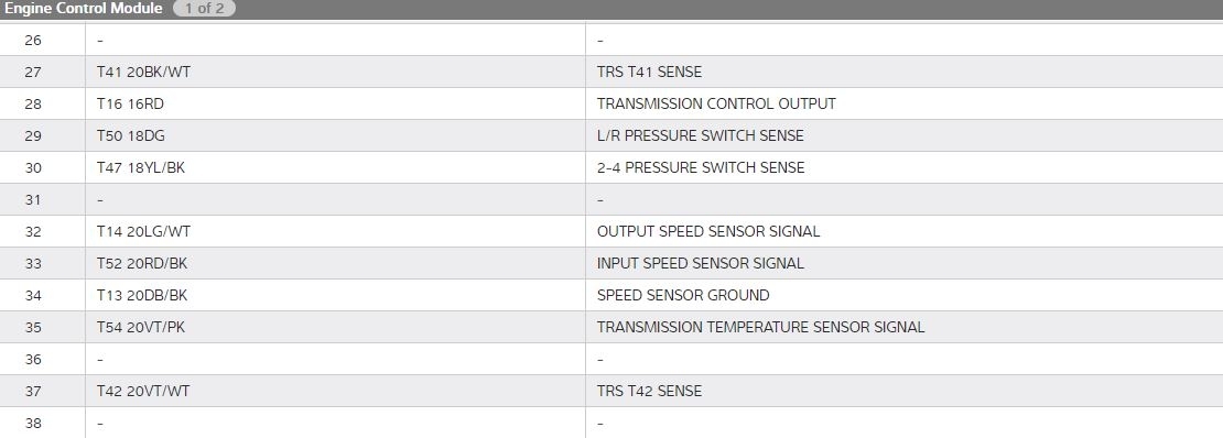

How to fix bad PCM connections? I think the c4 connector makes bad connections with PCM pins, inside the c4 connector there is a white pad surrounding the inside of the connector that pad is smashed up.

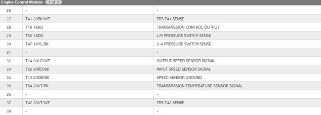

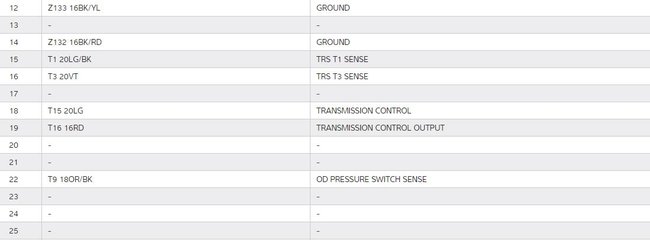

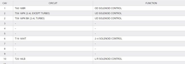

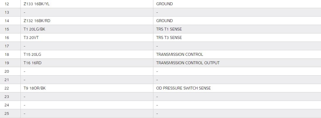

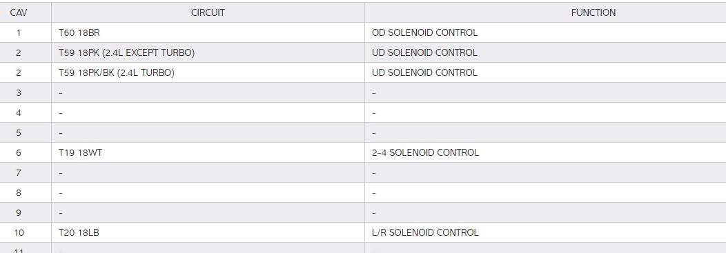

Honestly, they are nearly impossible to repair because of the size of the pins. I am not sure what symptoms the vehicle has, but I attached a picture of the C4 pin and the remaining pictures indicate their functions.
As far as repair, I would recommend replacing the harness if the plug is damaged.
Let me know if this at least helps you determine if the connector is the issue.

When I push the connector to the #4 PCM slot it will not click. The white pad I guess it is a weather protector is smashed. The symptoms are p0882 limp in mode and in a while p1603 and u010.

Hi again. The 1603 indicates an internal communication error the 882 indicates PCM power low and the U010 is not correct but a U0101 indicates a loss of communication with the TCM. The plug that you are having trouble with ties in with the TCM / PCM communications. I feel that is the entire problem. You may have to get a new harness.
