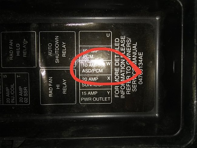

The fuse keeps blowing all the car was fine until thermostat was changed which is underneath the car. ran great before that. but when to turn the ignition had power to car but it wouldn't even turn over and fuse keeps popping.

Did you double-check your work to be sure you did not trap any wires where you were working? It sounds like something got trapped somewhere.

I've unhooked all connections including sensors still getting a dead short on the acm/pcd.

What is the number of the fuse that keeps failing?

W

Okay, the fuse controls the ASD relay and the PCM. I would disconnect the ASD relay and see if the fuse still fails. If it does, good chance it is the PCM.

Also just realized that my fuse for my gauges keeps blowing.

Ok so it's the ignition fuse on inside panel and the asd/PCM FUSE under the hood what's the easiest way to narrow it down?

Did you read my last post on what to try?
Did you do that test?

Yes but I didn't know that the ignition fuse on the inside was blowing at the same time.

One thing at a time.
what were the results of the test I told you to do?
