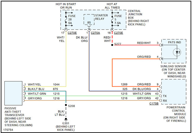

I was taking my dash apart and I unhooked the pats wires system. There’s extra wire connectors going into my floor panel wires and I forgot which color goes where so I am like lost.

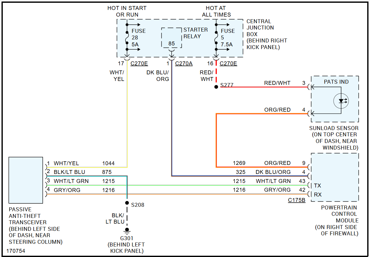

The extra wire could be the ground; here are the wiring diagrams for the PATS so you can get the vehicle put back together. Check out the images (below). Please let us know what happens.
