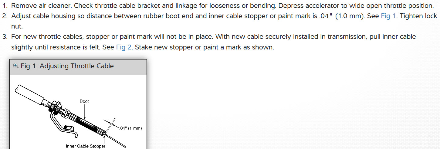

Just started, not slipping, need troubleshooting steps for passing gear not catching right away.

Check for a bad throttle cable or out of adjustment/broken etc. See picture.
